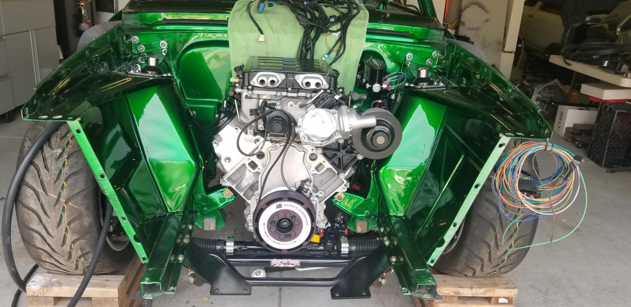

ve been working on my latest Pro Touring Nova. After all the mods ( DSE mini tubs, enlarge tunnel for tr6060, extra frame supports, etc) I finally got it back from paint jail.
Built LS9(800hp) converted to wet sump
Tr6060 with factory ZR1 clutch
TDS 9" Aluminum housing, Currie wave trac 3.89 35 spline axles
Willwood big brake front and rear
Intro wheel 18x10 and 17x7, 315 rear, 245 front
TMI Interior coming soon
Vintage air sure fit
Full CBR suspension
more to come....

Here is when I picked the car up and more pics of the progress along the way...

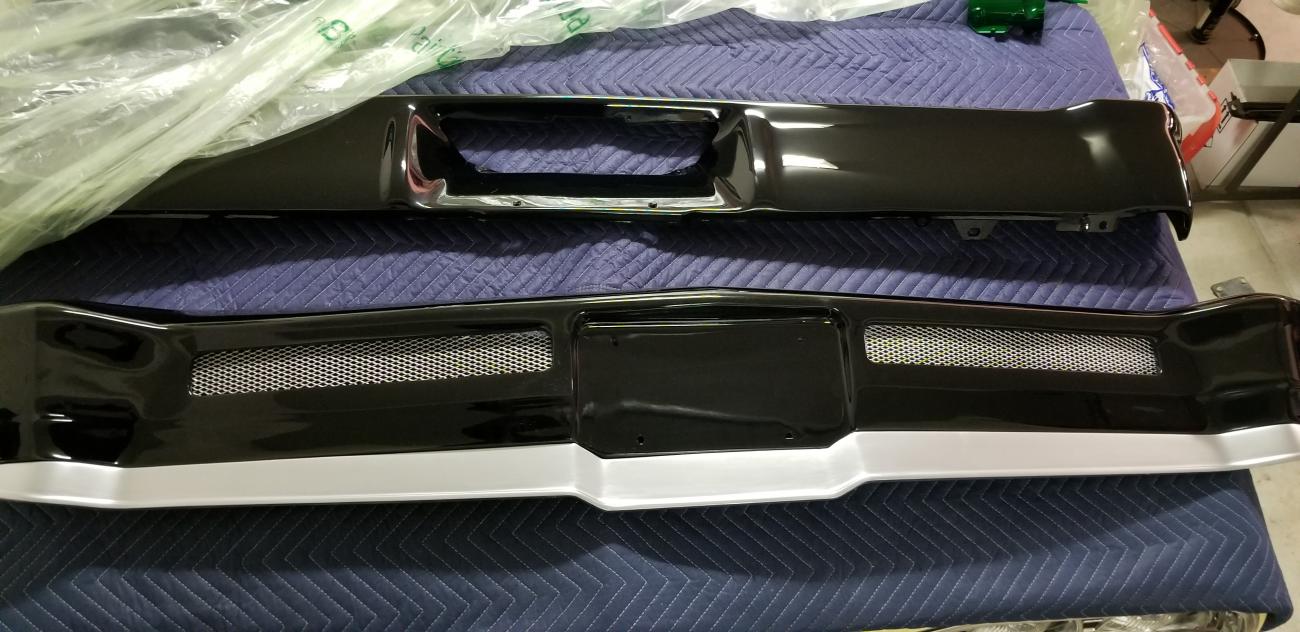

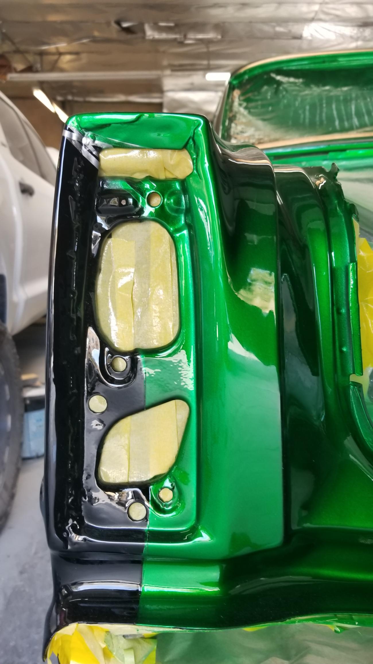

Here are some more pics, Ill add some info later.

Sick! Looks great. Did you make the air dam?
Yes I made it since no one other than Randys makes some and I dont like them.
