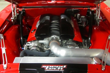

WOW we install then all the time and they look AWESOME!! they are not a "BOLT IN" they are made to fit with some modifications. here are 2 examples.

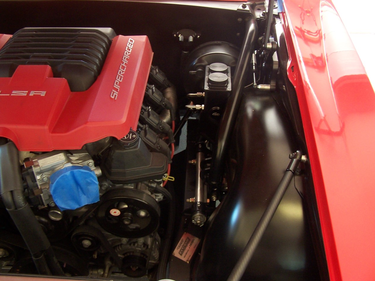

Here is a pic of the inners that I just got today from a customer

Show where the inner and the fender lip meet. Sorry they do not fit very well. I understand out of sight out of mind. However for my experience was they did not fit very well.
