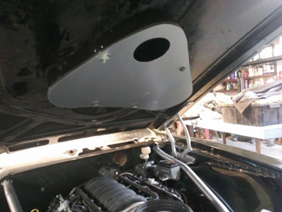

Having my car done by a pro in florida.
He had done so many subtle and not so subtle things to things to the car...
Here is one that i really love...he made the air scoops functional to make “ram air” work again.

Is the MAF going to be eliminated?

No. I’m no expert on these conversions...why do you ask?

What are you going to do for intake air filtration? Is there some kind of filter in that hood area behind the plate?

Bryan, I believe it's a triangle filter inside the housing under the hood.

There are two filters,one for each snorkel inside the triangular case.

Working on getting some better pictures...

Under the case
