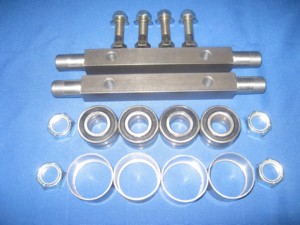

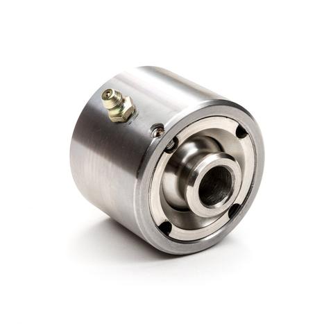

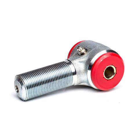

So what I need from everyone is to tell me about any holes in my plans. The other thing I'd like some opinion on is what size tubing is necessary for the front arms. 1"? 1.25"? Wall thickness? Mild steel or Chromoly? I know chromoly will be lighter, but I'll have to get a shop to TIG it (don't have TIG yet). Also, what version of connection points do you feel is better? What I've looked at so far are either spherical joints or poly-bushing. I also though about making one attachment point of the arms with a threaded rod so that mild adjustments can be made if necessary, or using an attachment setup similar to the early GM cars (bar between the bushings/bearings). See the pics below.

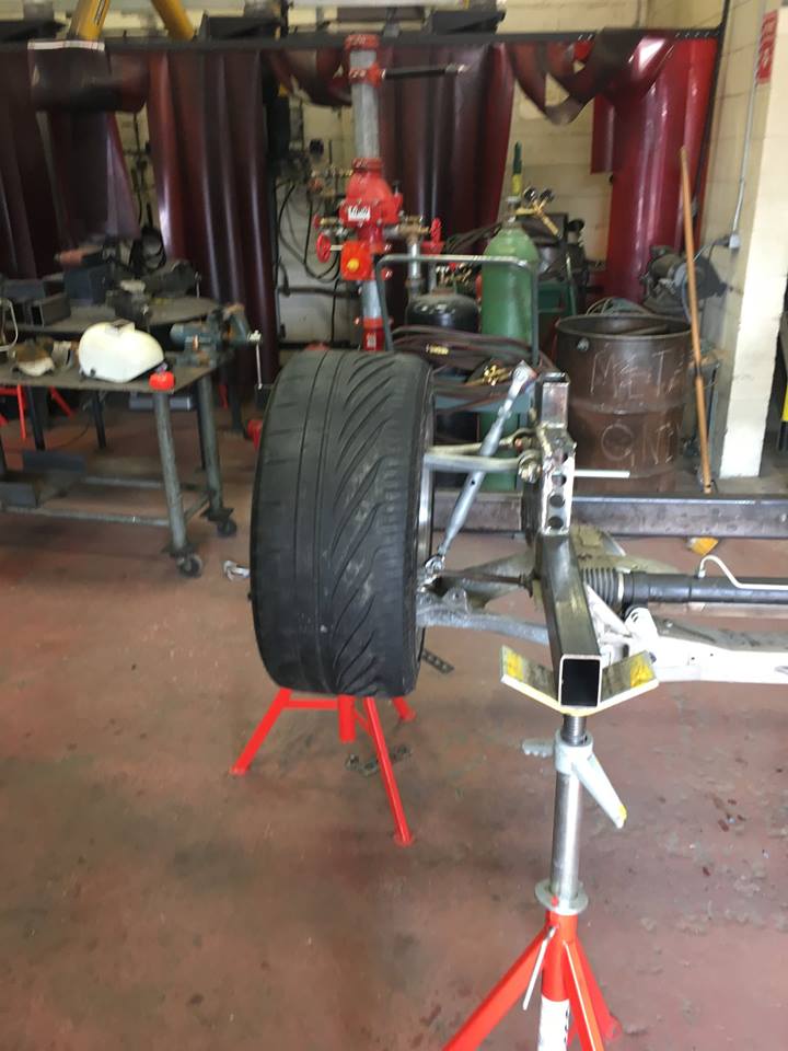

I chose to use the complete C5-6 front end. If it is too wide shorten the cross member, or fab mounts and shorten the rack. The rest is just drawing and designing.
