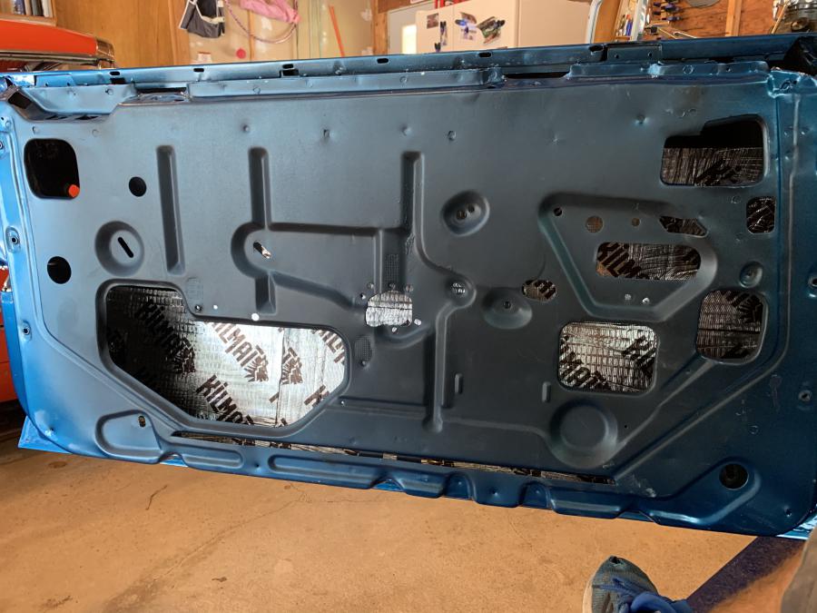

I just did the door skins and what a difference it made in how the door sounds and closes.

It is the first brand I have ever used so nothing to compare it to but it is easy to lay out and mad e a huge difference in the door. Plus I really liked the price

yeah ok, I've used others and also decided to recently use kilmat and I was very happy with it so far, especially the price for 80mil. I also bought the aluminum tape to seal the joins and I recommend that, for no reason other than to avoid getting black goo on everything, including my clothes as I continue to work in there

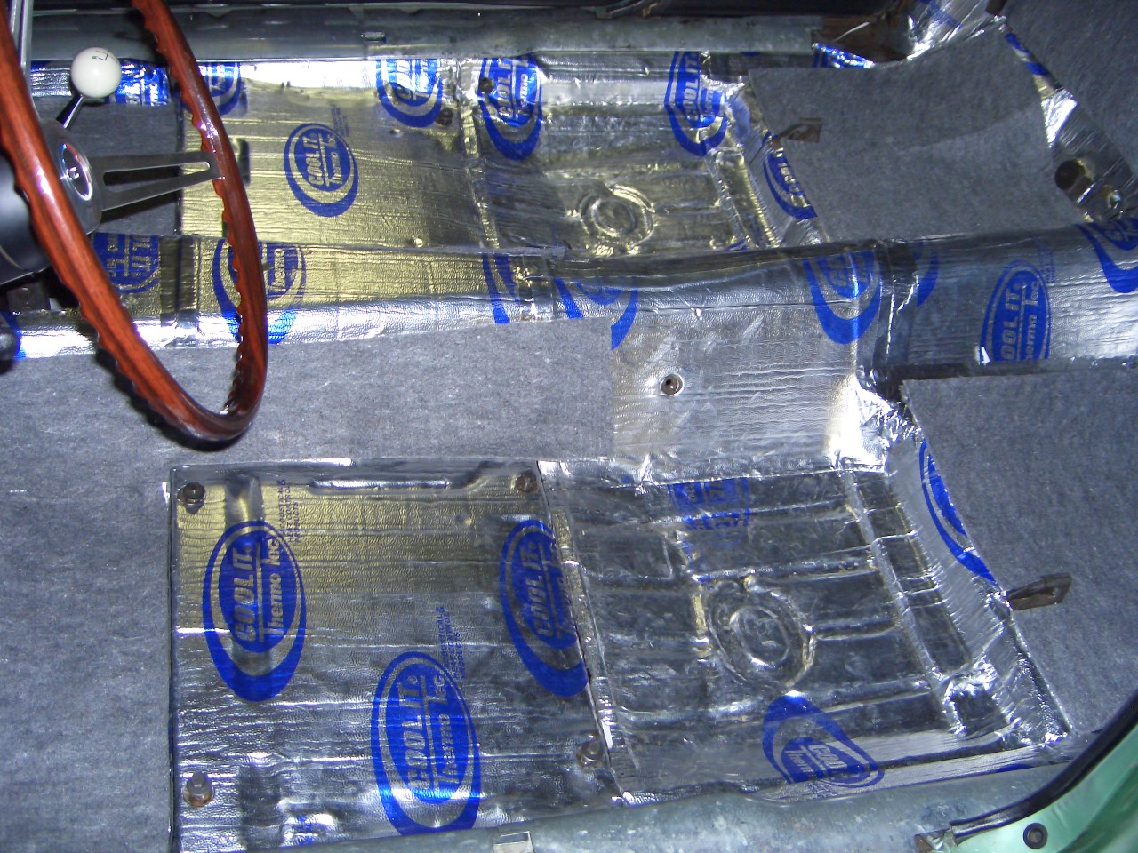

I ended up adding a little extra insulation around some critical areas where exhaust heat from headers, intermediate pipes and mufflers are routed as well as the back seat divider.
https://www.thermotec.com/products/s...hermo-guard-fr
I found that the extra barrier helped fill in the carpet better.
To punch around bolt holes......take a piece of thin diameter pipe 3/4"-1", grind a bevel around the tubing then hammer at areas that you need to fasten stuff to, makes a nice clean open area.
