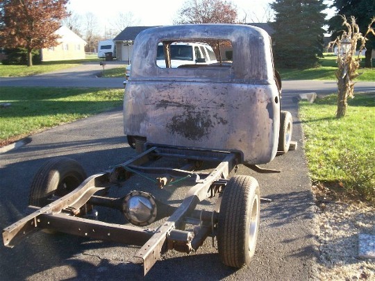

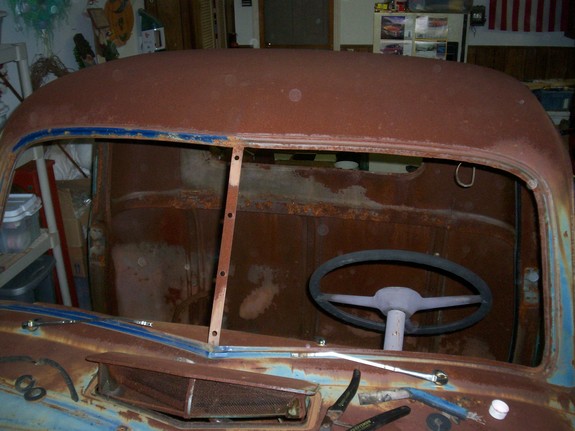

I have had really good results with sheet metal using this product. I have parts that have been treated with this product and left otherwise bare for years barely showing surface rust. I’ve included some before/after pictures, smaller parts were left to soak. For larger pieces I found the key to be agitation with scuff pads or a wire brush while keeping it damp using a spray bottle. The bed of my 51 is still bare years later.
For me, hydrochloric aka muriatic acid was far too aggressive and I had the same flash rust problems you’re describing. I also had concerns after doing research and reading about the potential for cracking due hydrogen embrittlement. I would personally not feel comfortable experimenting with cylinder heads, blocks etc. that I planned to use without getting input from someone that truly understands the metallurgy.
