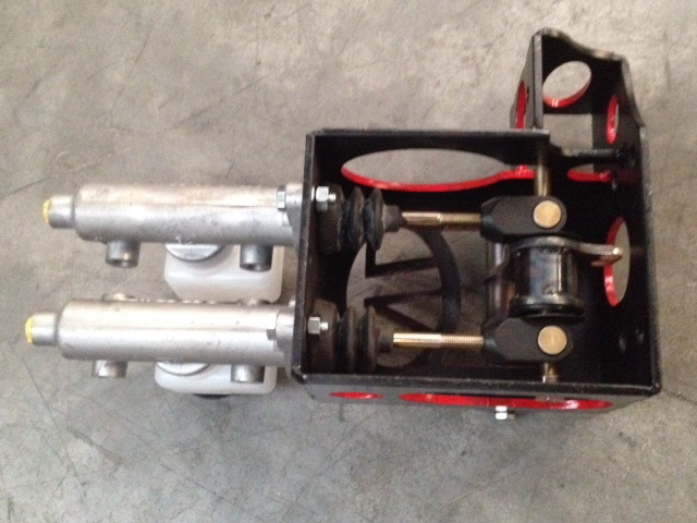

I'm actually switching from a hydroboost setup to manual brakes. I'd like to install a Tilton 600 setup but looking for some feedback as the install isn't trivial and not easily reversed.

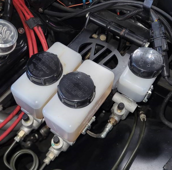

Wilwood just released this, which would be a much simpler solution than the tilton set up and provide the balance bar set up.
https://www.wilwood.com/Media/Brakin...eid=9c2c7cc5ad
Sent from my SM-S906U using Tapatalk
Neat!
That's very similar to the factory firewall to dual masters with balance bar adapter that CNC Brakes used to offer years ago, but the Wilwood piece looks much cleaner.

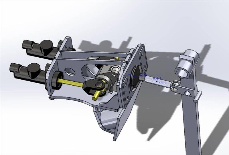

Rob at No Limit Engineering also used to build something similar (a bolt on 2 bolt factory style master cylinder mount to dual master with balance bar adapter) that had a built in swinging intermediate pivot lever between the factory brake pedal and the dual masters to minimize side loading on the bores of the master cylinders. His adapter offered multiple bolt locations on the intermediate pivot lever to easily alter the pedal ratio without having to redrill your factory brake pedal. Not sure if he still makes it or not, but it was a cool piece.
Wilwood simplified things even further and appears to just have the balance bar sliding in a slot on the adapter to avoid twisting the balance bar and putting excessive side loading on the bores of the master cylinders. The slider might have a little more friction than Rob's swinging pivot lever solution and doesn’t allow easy adjustment of pedal ratio, but I bet the Wilwood piece still works just fine.
While a new pedal assembly with a built in balance bar along with firewall mods is a much cleaner and more compact solution than a firewall adapter that sticks way out, the Wilwood adapter is a great way to see if you like the feel and function of a manual setup with dual masters and a balance bar before you go slicing up the firewall up to install pedals, or if you prefer a "no mod" install.

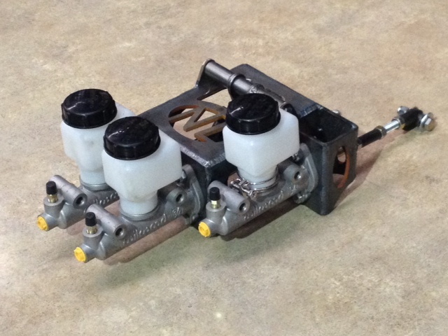

Someone over on PT just posted pics from No Limit's development car that's for sale, and it had a picture of Rob's bolt on balance bar setup.
It's not quite as compact as the Wilwood, but it does allow adjusting your pedal ratio by simply moving where the link from the brake pedal connects to the intermediate pivot bar in the firewall adapter. With the Wilwood setup you would have to redrill your pedal to alter pedal ratio.
If you didn't want to mod the firewall for Wilwood or Tilton pedals, that's the route I would probably take as you can easily adjust the pedal ratio between stock, higher, or lower by moving the link attachment point. He also offered them with a built in mount for a clutch master cylinder too, at least for 1st gen F-Bodies.
IIRC the 1st Gen F-bodies have a 6:1 pedal ratio in the manual brake pivot, which is pretty much where you want to be-- but having some easy adjustability is nice.
Either the No Limit or Wilwood setup sticks out from the firewall quite a bit, but you do get to avoid relatively permanent firewall mods. If you're going for the most compact look you can, it's hard to beat actually cutting and modding the firewall for Tilton or Wilwood pedals.

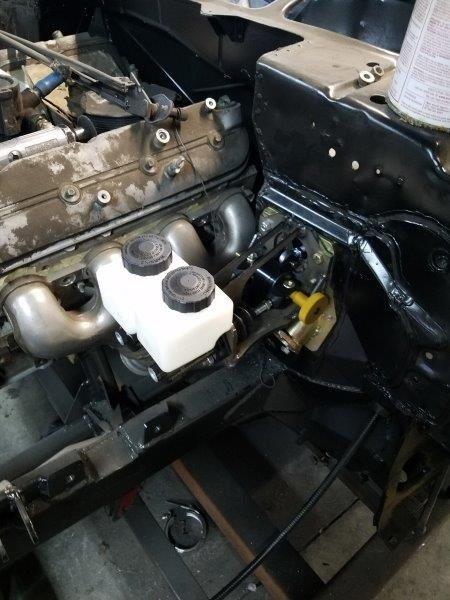

I built this system for my car. Seems to work good, and I increased the ratio to 6.25.
