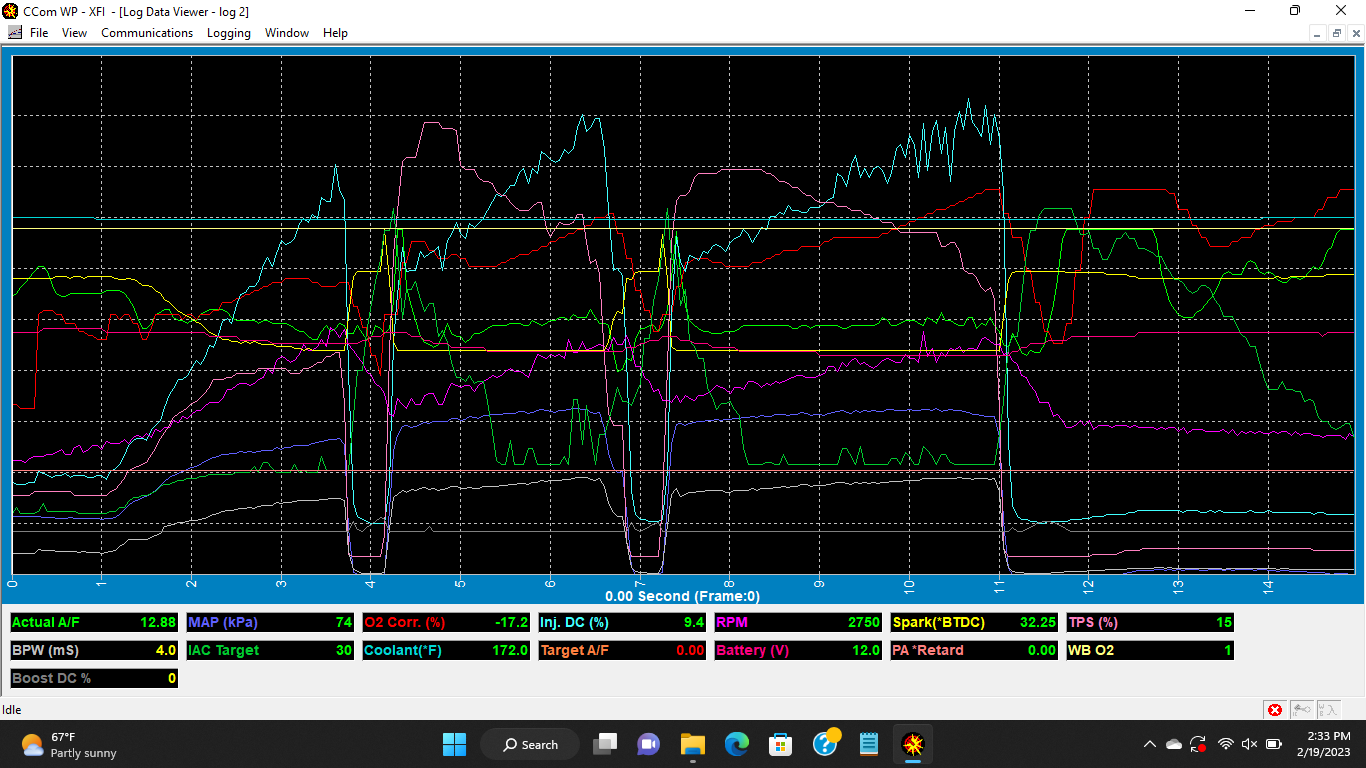

Old 02-19-2023, 03:41 PM
mdprovee's Avatar
mdprovee mdprovee is offline
Location: Suisun City
Posts: 1,155
Thanked 4 Times in 3 Posts
I took the car out today and removed the blower intake tube so the motor saw no boost. No cut out till the motor hit the rev limiter at 5500RPM. Then we connected the intake tube back up and ran it. The RPMs are around 4500 to 5000 RPM when it cuts out and around 7 lbs boost according to the guages. Here are the data logs. My plugs at set at .025 gap. Please keep in mind it is a manual car, so the big dips are me shifting.

Old 02-19-2023, 09:25 PM
Musclerodz's Avatar
Location: washington, ok
Posts: 4,286
Thanks: 22
Thanked 164 Times in 95 Posts
personally I would throw the MSD box in the trash. Every car I have ever used one on would eventually have issues. I would tighten your plug gap another .005.
