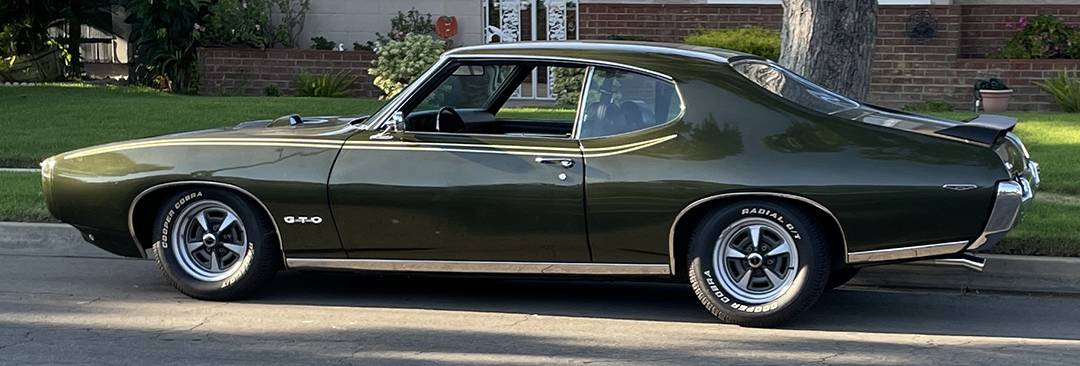

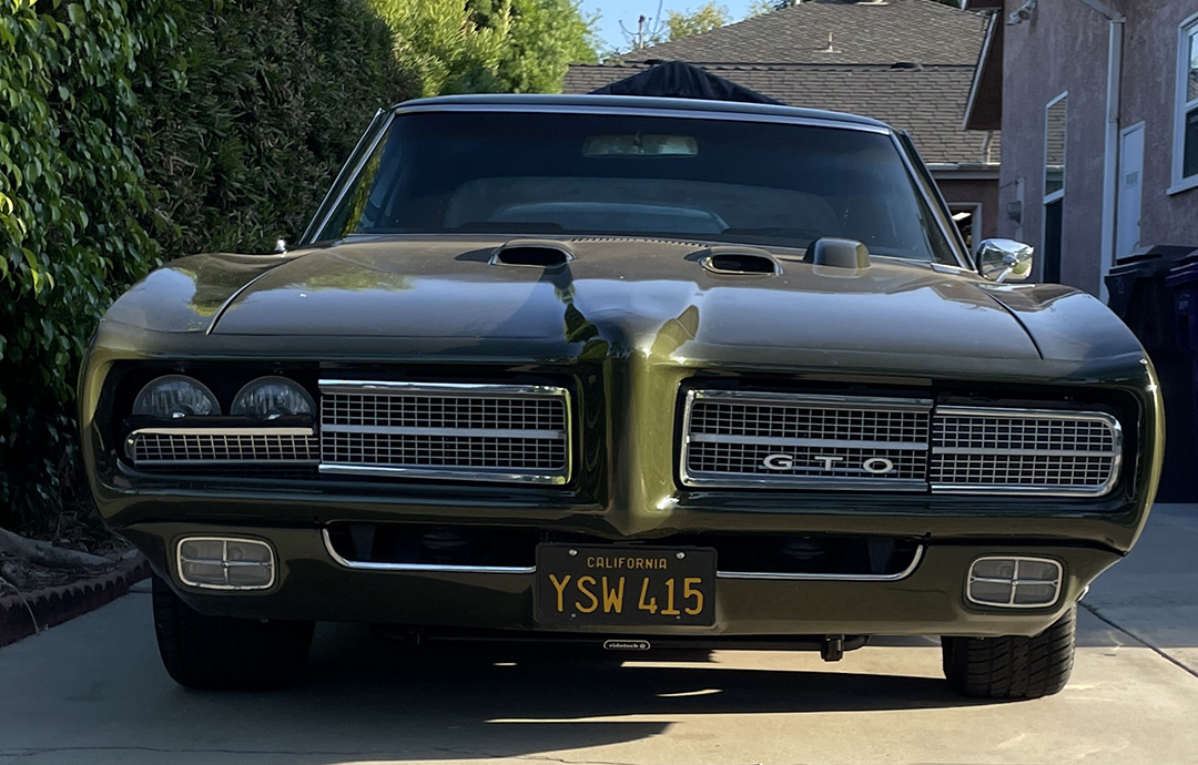

So I bought a Ridetech Streetgrip suspension kit for my '69 GTO and installed it just over the weekend and already the cars sitting like it has a flat tire/ leaning to the left all inside of 24 hours of installing it.
Specifics- # 11245110 StreetGrip system w/ "Big Block" springs (my car has a pontiac V8 so this should be stout enough to use)
upgraded to their tubular upper StrongArm A-arms.
- A-arms have the #1 bushing installed (it came with the kit and has a centered hole for minimal caster)/ arms are set in the street position
- Car has not been professionally aligned yet aside from me giving it a driveway alignment (setting toe in and using ⅛" shim on the upper rear A-arm bolts to give a bit of caster)
- OEM LCA has new rubber bushings as the ones in the kit do not fit my car. (turns out the kit comes with round bushings and my LCA has a pill shaped bushing)
- I made sure the front springs were clocked to their correct position during installation.
- I weigh about 215#.
The car had a slight lean to the left before this kit install but now it looks like I have a flat tire. It appears the coil spring collapsed or something. Did I do something wrong with the install? It should be sitting level left to right, no?

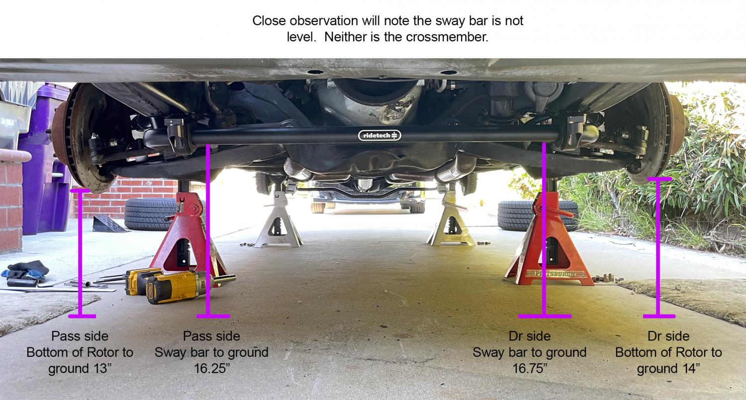

understood, and will recheck that later, but I think I found the real problem- my frame is bent and causing this left lean. While on jackstands in my driveway I was able to see this more clearly and confirm by measuring various points to the ground, and nothing is even close to symmetrical. So my next step is a frame alignment shop to see if they can fix this, or if I'm shopping for a new frame

That would do it. Bummer, but at least you know.
