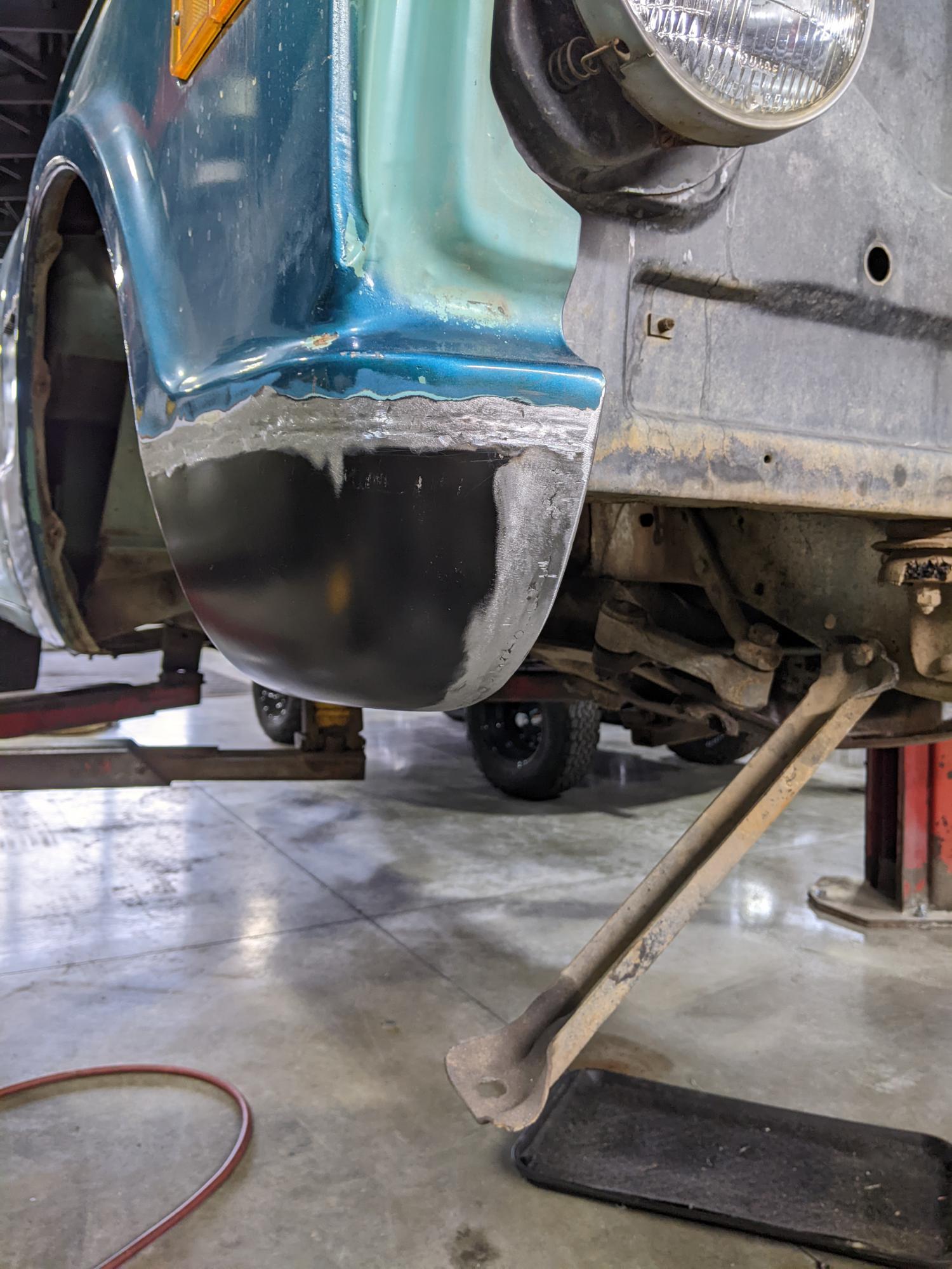

I did a new full floor, cab corners, rockers, and a new box. Plus a couple small patches. The new floors are so nice I had to do it.

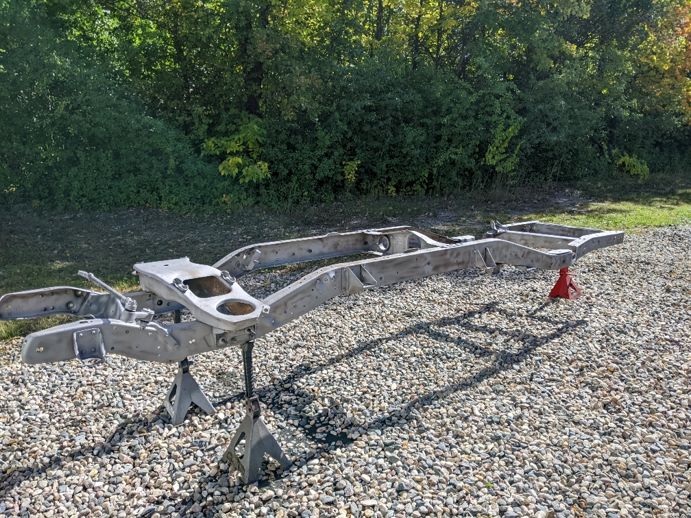

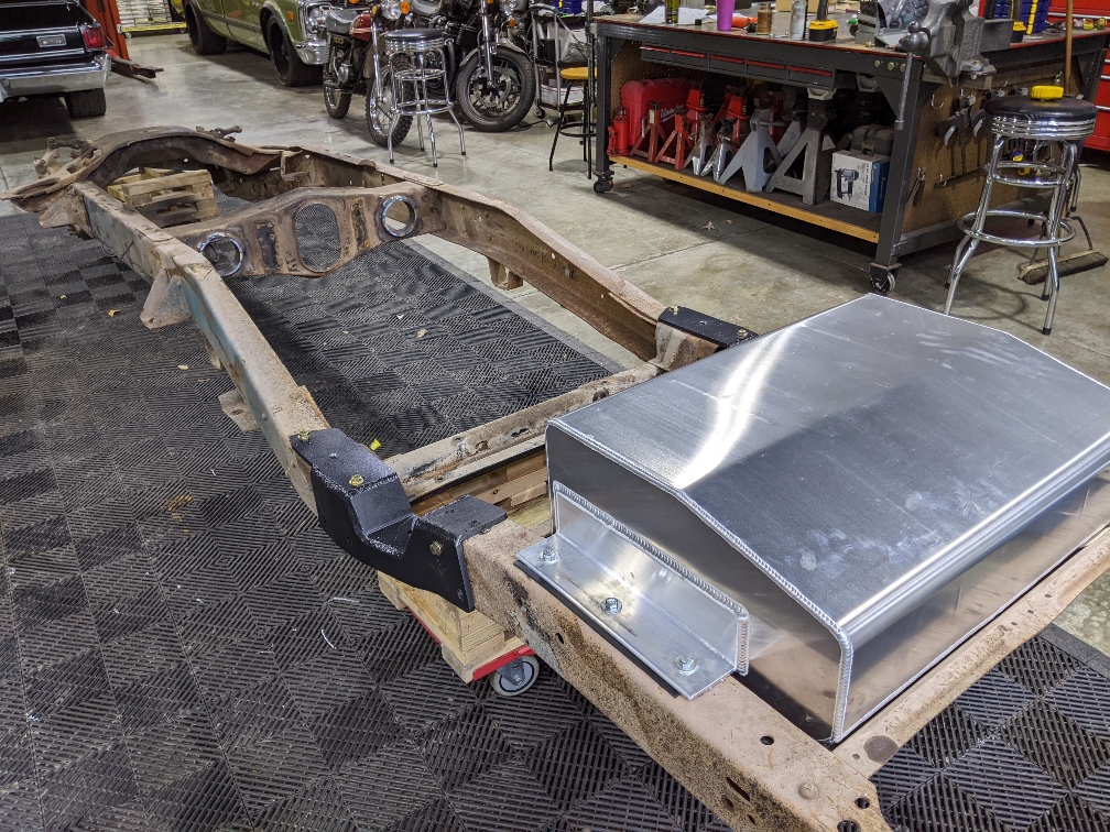

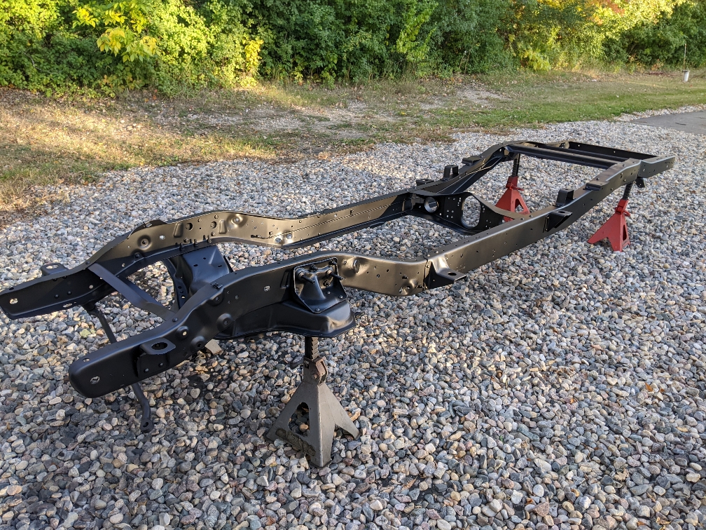

I did a c-knotch and exhaust pass through on the frame before blasting and painting it. The frame is super clean, no pitting. The fuel tank is from Boyds Welding and uses a ZL1 fuel pump. I'm just about to the more fun parts. So far it's been all cutting, fitting, welding, blasting, and painting. Just making messes.

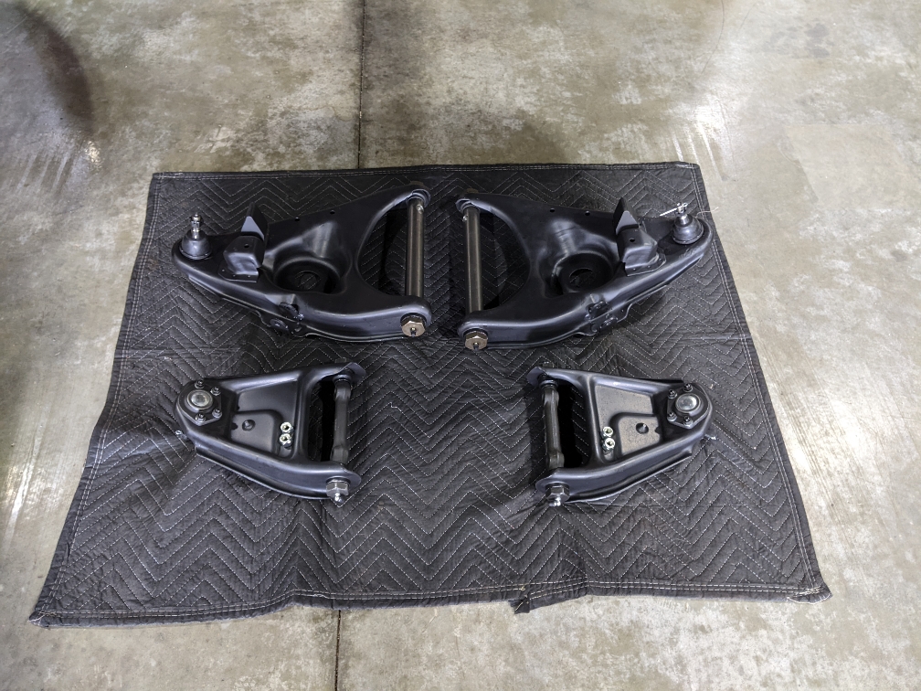

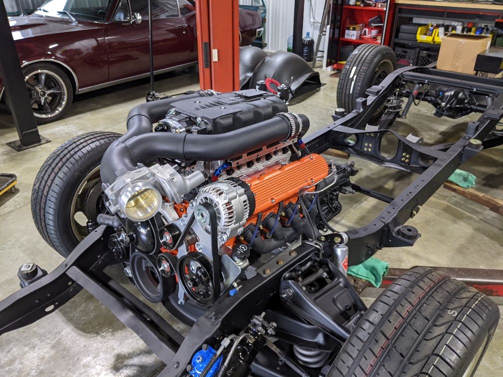

I rebuilt all the factory suspension and coated it with Steel-It paint (really good stuff). I converted the truck to 5 lug and used square body spindles and disc brakes up front. The rotors were branded Brembo and were 30 bucks at Rockauto. A set of decent KYB shocks, a rebuilt steering box from Blue Top and some 19/20 Halibrands round out the chassis.

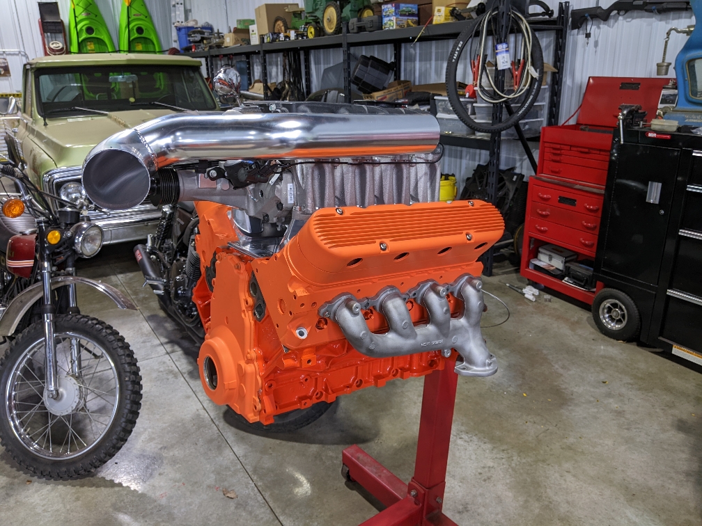

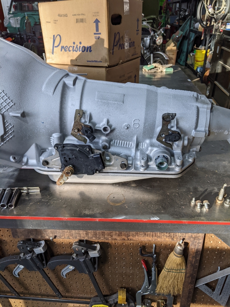

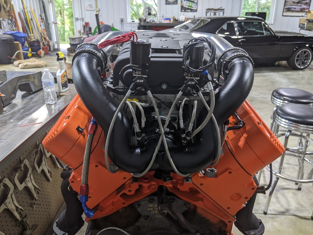

The motor is a 5.3 with gen 4 rods and forged pistons. I'm using the Summit Ghost cam, stainless LSA manifolds, Sts-v blower and a 150 shot of nitrous. A Holley Terminator runs it. Trans is a built 4l80e.
Sent from my Pixel 6a using Tapatalk
