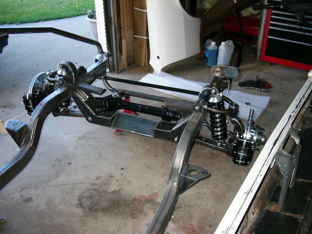

We did the same frame in a car and it was the flimsiest frame I have ever used. Welded pie cuts into it and tied it into the rockers ever 12", but still could not eliminate the flex at the core support.
Do yourself a little test. Put a set of jack stands at the front of the subrame under the core support and rear rails, then have a 200LB friend step on and off the rocker and watch twist delfection in horror.
I think it is a great piece for a straight line car, but not a G Machine.

Ours was a convertible. If we would have put the firewall bars in, all the stress from the flex would be on the door hinge pins and door latch pin. Bracing like that is always nice, but should never be required in threse types of cars. We had the splined sway bar.
There are some pictures on our site that will show the pie cut and rocker bracing
http://prodigycustoms.com/petes-camaro.asp

It does not show in thos pics, but we box plated it from the rockers to the subframe with 16 Gauge, which was over kill for sure. If you are doing a multi point cage, and making front down bars off the front hoop, surely that and some trianglation under the hood shoud firm it up.
