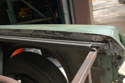

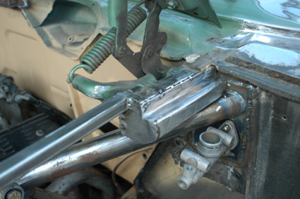

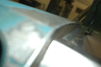

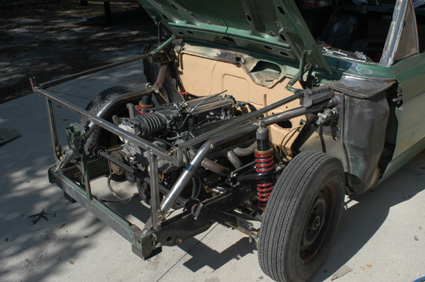

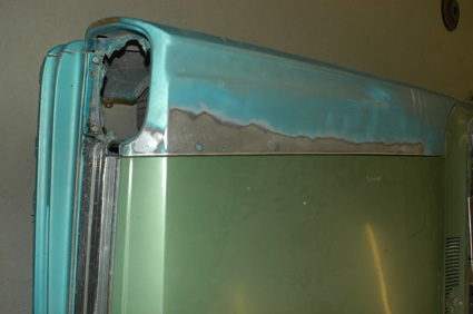

this was my day .remember ive "never done any mod/fabrication of this type before".most of whats been done is a first
.i started finishing the fender jambs this morning...some more tack welds and grinding along with filler and blocking..yes blocking the fender jambs...it has to look great!....also did a lil clean up grinding on some weld of the fend/core support i built...i also made the mounts for the front fender to bolt to the support.. rememer it has to be hidden and removeable many times.these are hidden forward/ bottom of fender .the gaps have to be perfect..today was the test....removed filled blocked reinstalled and they line up exactly like before i removed them for prep.. i included pics of my inner fender to fender jamb so you could see how they meet..no bolts showing and smooth...
also boxed in the hood hing mount on the back side..nobody will probably see these once done but it makes me feel better...that they look finished.
you also get good look at my master cyl. location ...
remounted front clip and the gaps stayed as planned ..SO IM HAPPY..
im ready to blow on some primmer in the fender jambs and strip the rest of fenders tommorrow...
ok pics below ....and let me hear your thoughts guys i always want motivation!!!thanks for looking

Man it's looking really good. I love the front suspension
