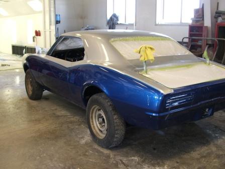

I am getting ready to order new wheels and tires and wanted to get some input. I have searched this site and few others and came up with this plan. First the car is a 1968 Firebird mostly stock suspension but 100% new / rebuilt with polyurethane every where. It has disc brakes on all 4 corners and a 9" ford rear that is only 1/4 inch narrower than the factory rear. Here is my plan.
Front 17 x 8 with 5" back spacing and 225/45ZR17 G force KDW2
Rear 18 X 9 with 5" back spacing and 255/45ZR18 G force KDW2
Do you think I will have any issues? I found a few cars with bigger wider tires on stock set ups that said they fit OK or had very slight rubbing when driving hard so I expect what I have planned to be ok but wanted to check other that have had experience with oversized wheels. Any comments welcome Steve

First I must say the car looks great! Those are my two favorite colors!!
The wheels will fit fine, the front is the 'works all the time' sizeing and the rear will work out to be the same as the 9.5" w/ 5.5" b.s (works all the time size).
The tire choice is limiting you a bit as they don't offer all the normal sizes. Your front choice is a little short for the car, I would like to see it be at least 25.5" tall (245/45/17), especially if you aren't really lowering it a lot. BFG's 245/40/18 @ 25.7" would be ideal. If you went with a 245/45/17 tire it would match very closely to your proposed rear tire sidewall size...I think if you go larger diam. on the rear wheel it still looks best to match the sidewall heights, this makes the whole package appear well thought out.
The rear tires are taller but I know you have some fender well to fill and I'm all for it. My car (68 camaro)
is quite low so this isn't as much of an issue for me. I think you are on the right track here! Just set your final ride height the best you can so you can really nail the tire fitment!!
If it were me and I was really wanting that BFG tire I would get the 225/45/18 and the 255/45/18. This would give you a very close sidewall height between the two (rear sidewall .25" taller) and more importantly the sidewall to rim would be stretched the same on both wheel widths...I think they would look great on your chosen wheels. This of course isn't the widest package you could run, but it should fill everything up nicely (as long as you have lowered it a little) and not have any rubbing issues!!

I should have stated in the first post that I all ready have two 17 X 8 JYD rims that I picked up from a guy that changed his mind and never used them. I was going to put them on the back but got thinking they would fit on the front and I could get bigger ones for the rear. The problem then is 17 inch JYD rims only come as 7,8 or 10 inch wide and i am afraid 10" will not fit with out mods. Soooo i thought maybe the 18" X 9" would fit nice. I understand what you guys are saying about 18s all the way around but finding it hard to get my head around all the measuments and how they will look on the car. I do expect I may have to lower the frt of the car some what and maybe the rear as well. The more I think and study the more unsure I get. I can't afford to buy rims untill I find a combo the looks right this is a one shot deal.

Thanks for the comments. It is great to get help from guys that have been down the road I am about to travel I am more stuck on the rims than the tires. Do you know a tire company that makes a 26 inch tire for a 17" rim? If I have 17" rims and 26" tire on frt and a 18" rim with a 27" tire on back then I can lower car as need to get the look i want right? I really like the idea of keeping the side wall size the same and am willing to change tire companys to get it.

Thanks for all the help. I am going to go with your plan 245/45/17 and 255/45/18. now I have to pick which tire brand.
