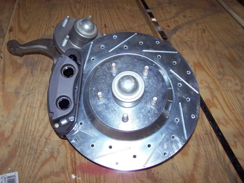

The project is hard underway Scott has a few pics up on the page and alot more to come, the engine is ready the chassis is at the blasters we ended up pulling the body off there were a couple minor issues that needed attention when the frame is back and boxed there will be pic posts and expence report as well, The front brakes are in we keept the budget in mind front brakes lines spindles and hubs at $600.00 By shopping PBR calipers 13 rotors.
