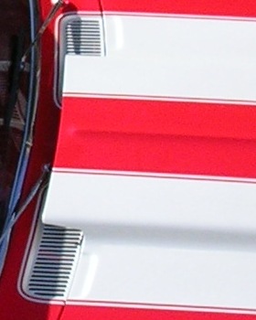

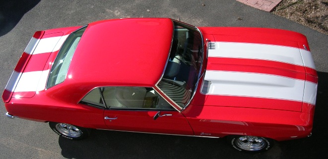

I dont know the width, I am not around to measure. But it goes outside the cowl. I attached a picture. I think the best way to go is to get a stencil kit to get them right. But I hope this pic helps show the cowl area.

Thanks BC69! Great pics.
