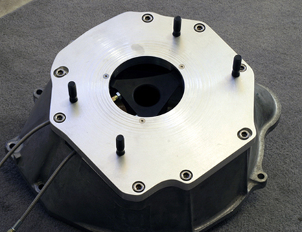

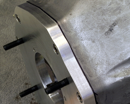

Brian Schein and I made one that bolts to the factory bell.
It's been working great with both a QMI Tri-lite and Howe TOB.
Or you can use an aftermarket from either McLeod or Lakewood.
Or you can use a GM BBC 168 tooth bellhousing. The only problem with the GM bell is that most of them don't have the 12 o'clock bolt hole.
