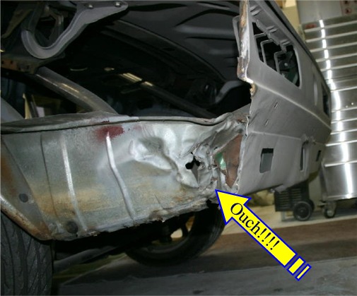

Just got the rear qtr off on the driver side and found some damage (see the pics) to one of the panels behind the qtr from a previous engagement with a LTD wagon in the mid 80s. The question is, does anyone know where I can get a new one or what the proper name for this part is? Also, I need to locate a part that welds to the inner tub and connects to the trunk hinge. Is there an aftermarket piece availabe for this or will I have to fabricate one? As always, your comments are appreciated.

you need the "LH trunk floor to rear quarter panel"
The hinge part?? I don't believe they offer that part, but I may be wrong. I wish I still had my junked 68 bird. I find parts that I could have used all the time.

its called a drivers side trunk dropoff or trunk support. i had to put 2 of them in my car.

I have a pair of the brackets that go from the wheel tub to the hinge. If you want them send me an email - zachary188 "at" aol.com

I think they reproduce the trunk drop off's.

There called trunk drop offs U can get them from good mark industries $30.00
http://www.goodmarkindustries.com/HomePage.html

that is the name I got out of classic chevy okc. my ricks first gen says drop off
