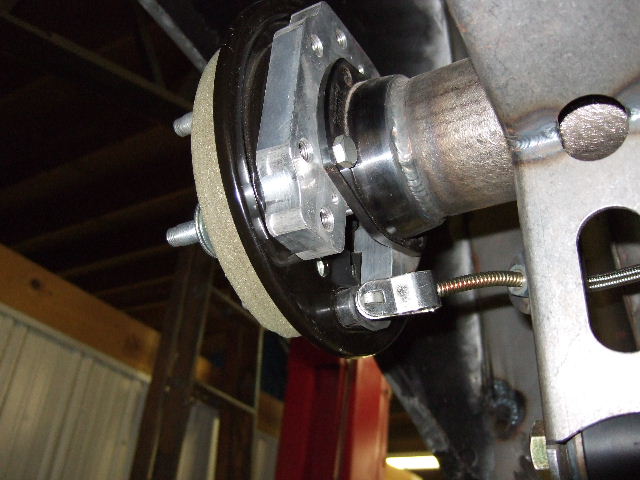

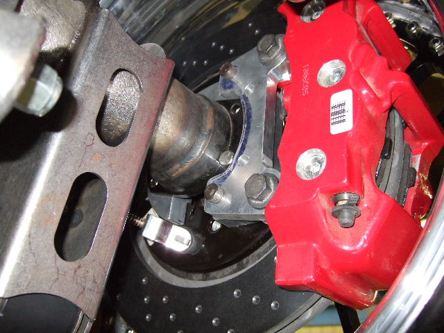

I had these brackets made to mount the caliper,backing plate(for original parking brake) and also hold the axle in. I am using a 12 bolt housing w/ large ford bearing ends. I used a lokar cable kit. If this will work for you, let me know, they can make a set of brackets for you. As of right now, I don't believe anyone makes anything else for this situation, but by now, who knows, things change everyday in this hobby!

Great info again! I have been thinking same thing for a while. If you can please give more pics of brackets. What do you mean at those brackets hold axles in? Like holding bolts will go thru the axle housing bracket , bearing flange and the vette part and mounts all together ?

Yeah, that's pretty much it. I'll try to get you some more pics asap.
