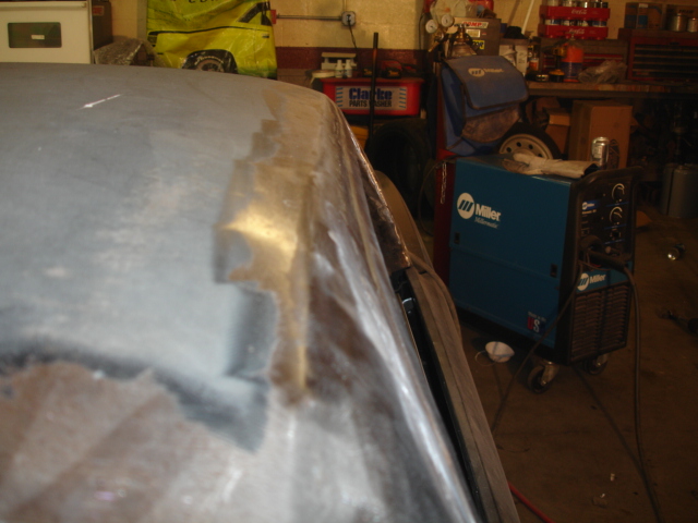

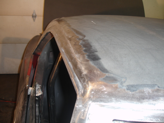

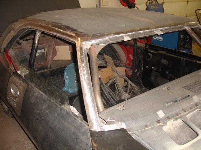

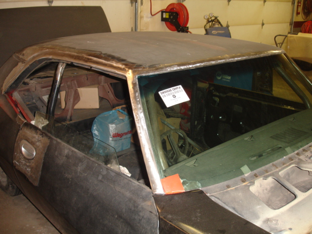

here are some pics of the flush glass,I've got to say that was a pain in the as*,I do alot of metal work,and it made hanging quarters seem like childs play
I told you it was pain. What are you doing at the bottom of the windshield.

I'm going to bend a peice of flat bar to the shape of the window and run windsheild rubber trim across there
