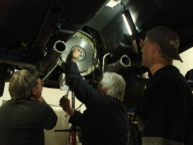

We have been thrashing and working on Penny pretty hard for the last two weeks in hopes of having her at the Good Guys Del Mar show. This was especially important for the shop, Best of Show, Coachworks in San Marcos since it's thier home turf.
We had two main issues (besides the crappy electrical guy). The first was low oil pressure. I'm pretty sure it's a bad o-ring on the pickup tube. I dropped in two extra quarts and the oil pressure went from 8psi to 25-30 psi. The car can be driven slowly, at low RPM, so it should be good to go for hitting the show. (I'm inside so I only need to park the car and leave it).
The other problem was an inop clutch. The first issue we found with it was the wrong size clutch, so it wouldn't release. Dick at Best of Show dropped the trans and replaced the clutch. When back together late yesterday it was still inop. I got the call and got out there last night (and I was sorta sick for too much sun covering the Super Chevy Show).
Anyways, Jeff Mortenson of Classic Chevy 5-speed and his VP of product development, Jim Goodlad (aka GM Jim), came by the shop at 8pm last night to take a look. Jim is a tranny wiz and knew right away that something was wrong. Next thing I know Dick, Jeff and Jim say "lets pull it out and fix it". We pulled the trans, found the issue and put the trans back in. Finish time was midnight. All three had tons of work to do the next day yet they stayed to try and make my junk work. Hell, Jim still had jet-lag from coming from the east coast.
I've always said that this hobby isn't about cars, it's about people. Nights like that show me that the statement is as true today as it has ever been.
Thanks to Dick of "Best of Show Coachworks", GM Jim and Jeff of "Classic Chevy 5-speed" for going the extra mile to help me out.
Here are three very good people helping me out:

First was that the clutch was a 12-inch unit.. too big and wouldn't release. Switched to an 11-inch.
Second was that I didn't properly trim the backing plate on the SFI scattershield. This caused it to bow out and interfer with the spinning flywheel. I should have known, then again there were no instructions included with it. Oh well, live and learn.
