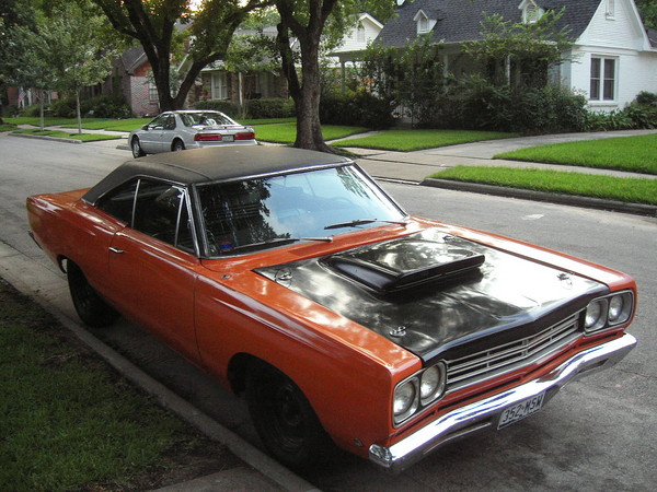

I've got a 1968 Plymouth Roadrunner that I am taking a distinctly different approach on. I am straying about as far away from a drag race oriented set up as possible. I would like to be able to do some auto-x on the weekends and do the twisty back roads of central Texas with ease.
The car will weigh way less than 3500 lbs. without me in it, it is pretty much a stripper model with Power Steering being the only true luxury. Like I noted below, the biggest pitfall will be the 15" steelies with Yokohama Avids. I plan on going with a set of Anarchite Torq-thrusts in 17" next year once I wear through the current tires.
Here is a shot of my Junk..
I copied and pasted this from Moparts...tell me what you all think.
