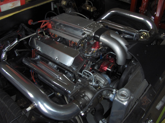

Hello all, i have been working on a SBC with a twin turbo set-up for 14psi, i currently have a Holley stealth with 950 pro injection set-up with narrow band 02, this is the set-up i was running when naturally aspirated worked great. I added turbos 55lbs injectors and 2 bar map, now i have been unable to get the engine running right, running real rich smoking etc... I have been told a wide band 02 is required for tuning any forced induction engine. Holley make a wide band add on kit, however i have also been told that Accell DFI genVII is a better set-up.
Has anyone run the Holley 950 with boost? is that the right way to go or convert to DFI?

Default turbo headers
Thanks for the info on the C950, i knew i had to go with a WB02, but did not want to buy it if the C950 was not a good system to use with boost. Not the case, i will but the WB02 kit. in the mean time I did try to tune with the NB02 and i am assuming due to the fixed A/F ratio i can not get it to run crisp, seems to run real fat at idle.
No china headers here, i made this set of headers from 2" mandral pipe. I can't imagine what you get for $200.00, It cost me $200.00 just to have mine ceramic coated.
