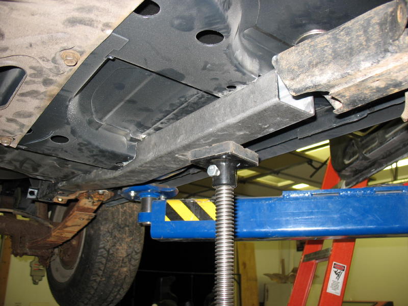

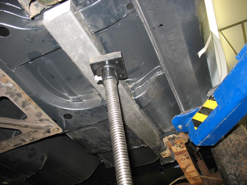

Here's a picture of mine. There will be a small gap.
I posted an install thread over at PT:
http://www.pro-touring.com/forum/showthread.php?t=7917

WOW! that's perfect. nice welds. I was able to do a little more triming and got min about the same I may have on longer gap but it should be ok. I should have pictures posted by sunday.
