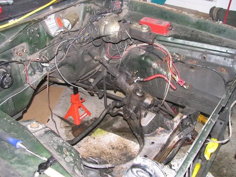

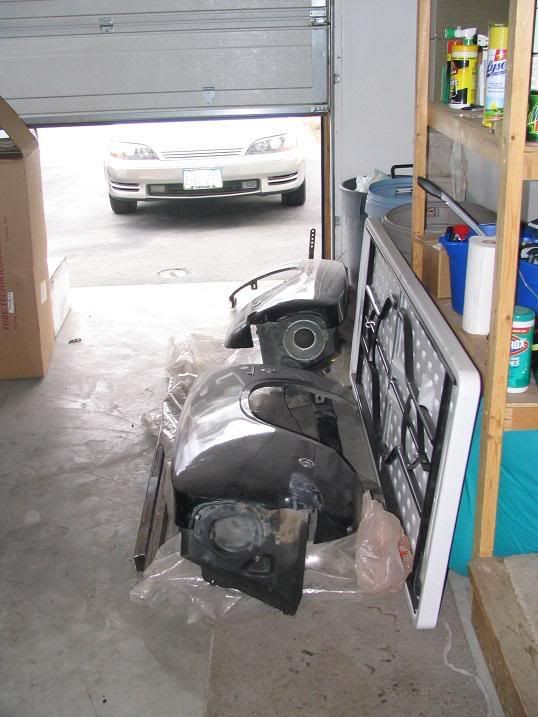

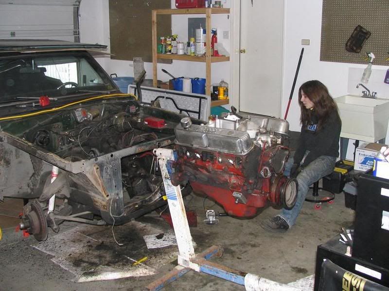

Since the last post, I've taken off the fenders, doors, and basically I'm attempting to clean everything up. Got the woman to start cleaning and grinding away at the dirt and grime and grease in the fender wells, and in the engine bay. The car is just caked with crap! 40 years of dirt, and at least 20+ years of a leaking power steering box has made alot of nastiness.

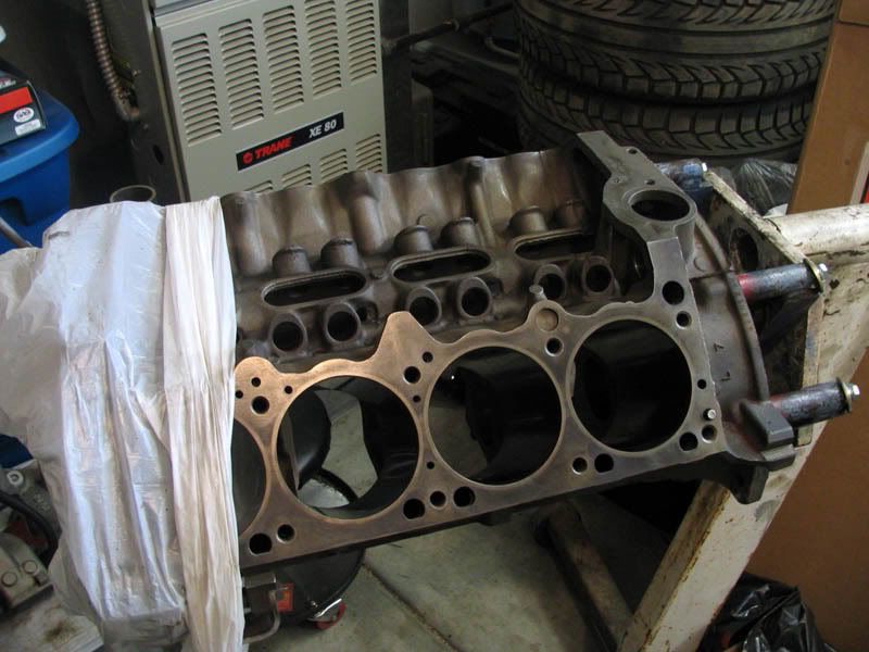

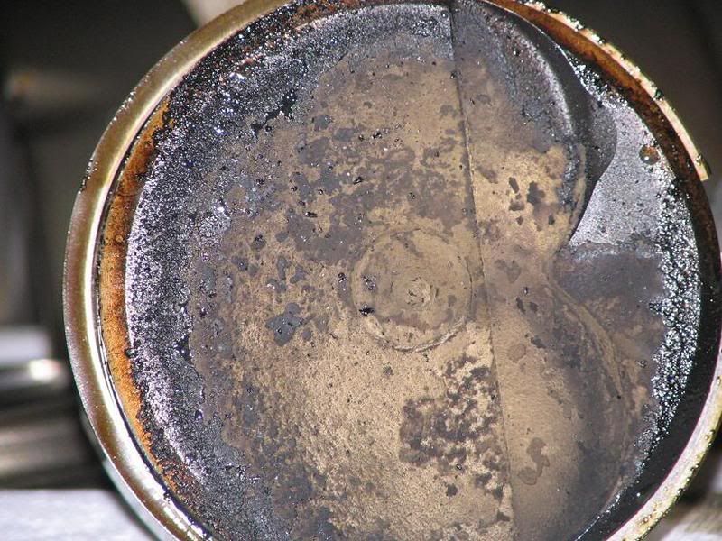

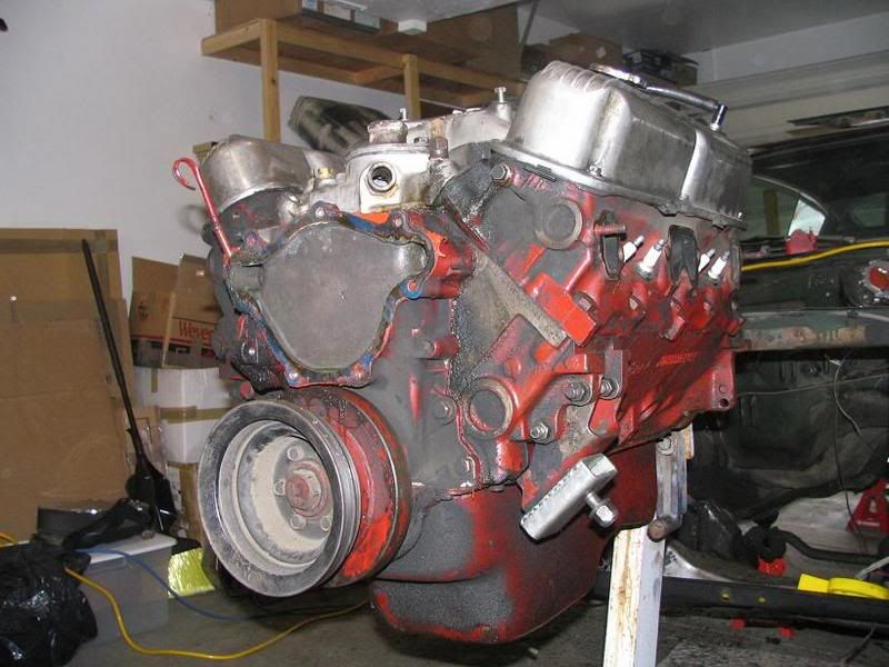

Also got the engine and tranny pulled, and the engine torn down. The pistons look like crap. No wonder I've been pinging horribly, and requiring a ton of Octane to get anywhere. May be ordering new pistons today, but still not sure if I want to do that, or stroke it. Pro-Charger was my original choice but I may change that for now. Heads look ok for the stock X-Heads. (Anyone know the CC's?) and the rest isnt bad. Found some Eagle H-Beam rods in there which was a nice surprise. Bearings look good, no abnormal wear or anything. Just the buildup on the pistons. Also found a windage tray on the inside. One less part to buy!
Pics incoming.

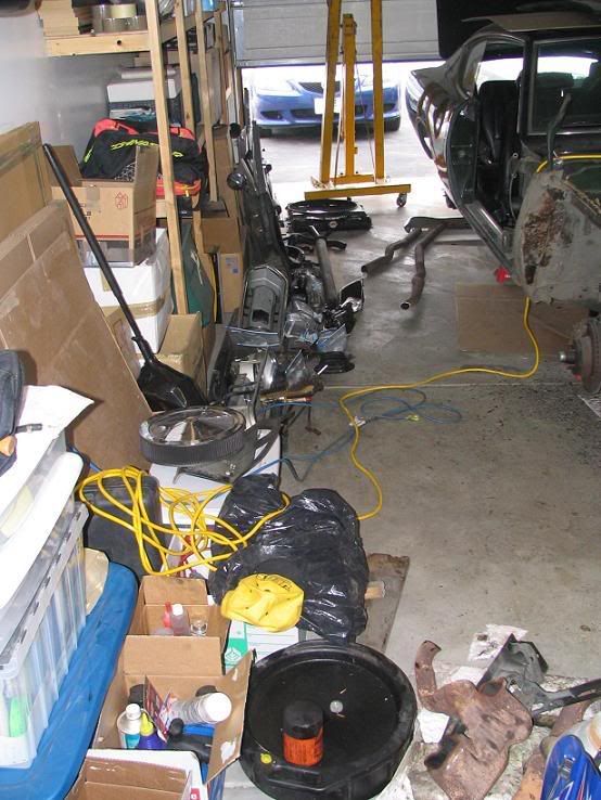

More pics of the engine torn apart.

Got some more things done. The block and crank are back from the machine shop. They were able to just polish the crank, and hot tank the block. We got it honed and put together, but have to take it apart, as the instructions for the piston rings weren't too clear... we talked to a buddies dad who was an engine builder/machinist for 23 years... he set us strait. Either way, it won't take long.

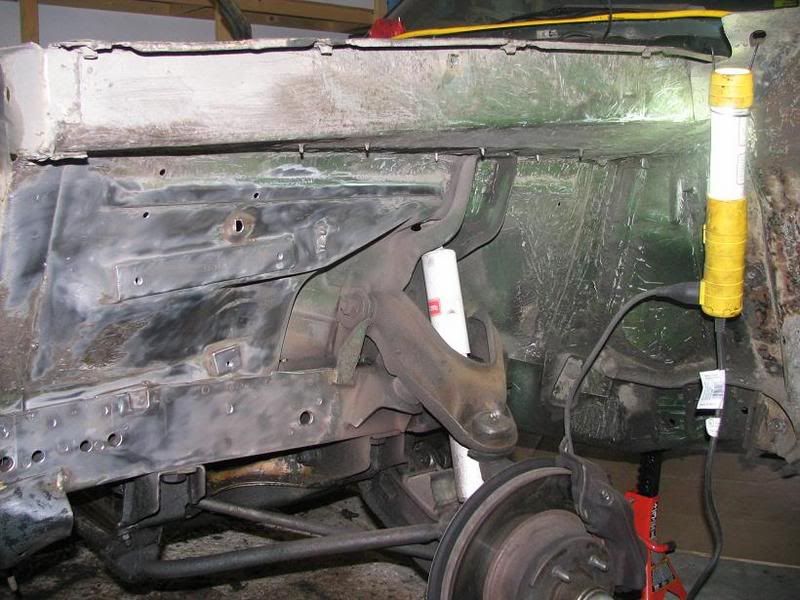

Other then that, I got some more suspension parts in. Things cleaned up. Painted the K-Frame and the lower control arms. Also welded Lower control arm stiffening plates on and will repaint and install those as soon as I'm done scraping and scrubbing the grease off the front end.

Well, got a bit more work done on the car before our camping trip last week.
Got the engine bay painted, as well as the inner fender wells.
New upper control arms (Yes, I know they're on backwards, I just wanted to make sure they fit and get the camber close).
Also got my strut rods installed, they're very solid and easily adjustable. I love the way they look too! Got the K-Frame painted and all pretty, welded some things on to stiffen things up, as well as stiffened the lower control arms with the Braces. Cleaned up the brakes, painted the calipers an aluminum color to match a bit better.
All in all, got a decent amount done, but not as much as I wanted to.
