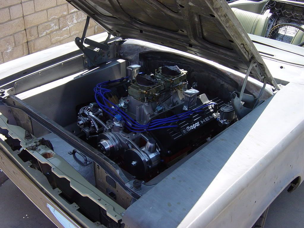

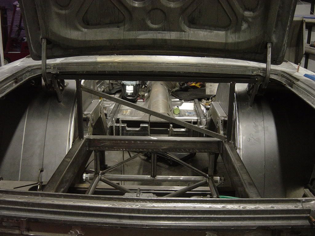

The guys at Psm Performance Fabrication would like to say hello and introduce ourselves and one of our current projects, a 66 convertible Plymouth Satellite. The car is currently 60% done. All sheet metal/chassis work was done in house. The engine was set back 3 inches from the stock location and dropped to lower center of gravity, while keeping it all under the hood
- Custom dual quad 426 Hemi
- Torqueflite 727 w/Gear vendor overdrive
- Full 2x4 chassis
- Dana 60 3.73 Truetrac posi
- Modified four-link w/ x-bone for lateral control
- 3/4 inch Speedway eng sway bar
- QA1 coil-overs mounted out board of frame
- Tubular upper/lower control arms
- GM F-body 2in drop spindles
- T-bird power R&P
- Speedway eng front sway bar 48 spline .188 wall
- Willwood four piston disc brakes
- Willwood master & proportioning valve
- Boyd coddington classic II front 17x8 rear 18x10
- 30 gallon custom gas tank
- more coming soon..

Looks like some really nice fabrication there. I'm impressed!
That engine looks like it's going to thump too!

I'm curious - more specifics on the front suspension if you can?
It looks like a GM spindle???????? How did you design it etc.
I'm just curious and nosy. The car looks sweet. Keep the pics coming!

That's a sweet looking rear suspension setup. Are your rear wheels on backwards in the 2nd pic?
