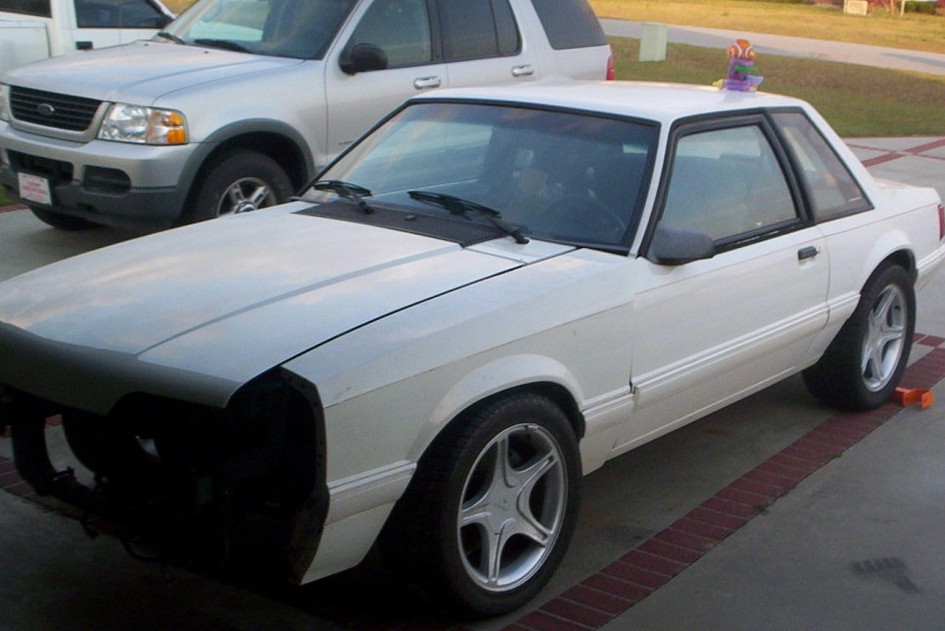

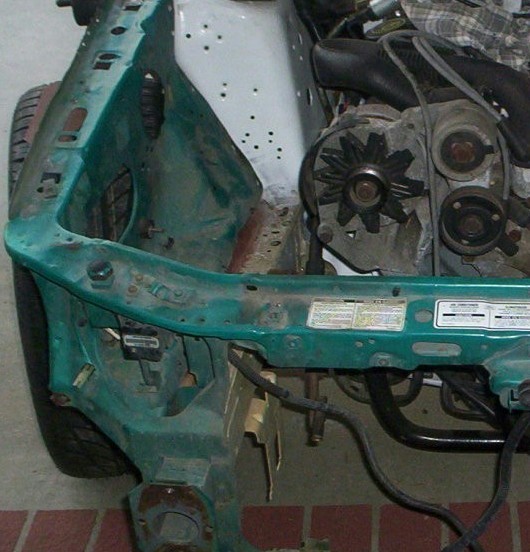

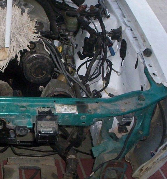

fitted a new core support this weekend
pics attatched
its not welded in yet but closer to what i want. this was a 4 cyl conversion and the bottom of the original core was flattened out. the air box side was heavily filled with bondo. The frame horn on the pass side had to be tweaked down and to the right slightly about 1/2 inch. HOPE TO BE BACK ON ROAD THIS SUMMER , and begin heavy engine mods and paint. the fender in the pic is not bolted down, just hanging in place to motivate me more.

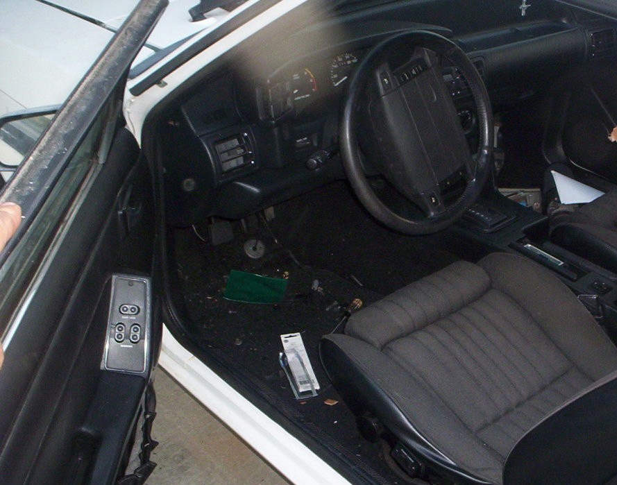

Default some details
Car has 95 gt suspension, 4 whl discs, installed mint black int from another wrecked notch, , 302 mass air, and my 3 month old daughter was pitching a fit. Gave her back to my wife. Anyways, plans are mild supercharging, aluminum heads, and all the basic mustang mods. Now its leaning towards being my wifes toy and Ill get another malibu project as I mentioned in previous posts.

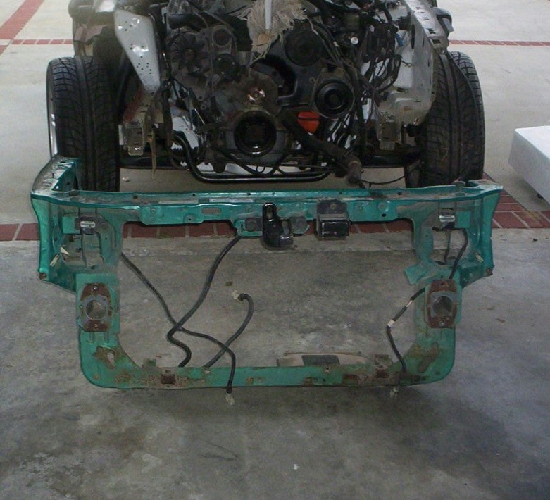

Default 3 more pics
here are two more core pics had to resize them

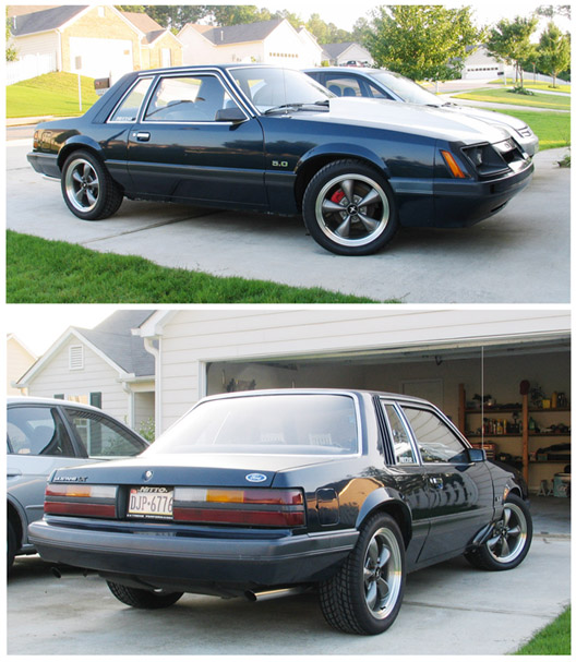

Hey hey! I'm not alone with my PT notchback! Alright a fellow fox Mustang guy. I'm getting ready to get back to my 85 5.0 Notch project here this week. Getting ready to order a real nice set of 18x8 and 18x9s with custom backspacing for it. There's too many Ford Wheels on these Fox Mustangs so I'm ordering a wheel that I think nobody has fit to a 5.0 yet. It's modern and vintage at the same time. I should have them on the car by the first of April.
As a tip on these fox bodies - if you want to keep the fox-length rear axles and still use the SN95 rear brakes, check out North Racecars. The SN95 rear axles with the disc brakes push the rear axles out a little over a 1/4". They made their own custom NHRA approved 5 lug axles and caliper brackets.
http://www.northracecars.com/catalog/brakes/brakes.htm
Anyways, I have two of these money pits, I mean projects and most of the time they're fun. Keep us posted on the coupe!
Here's a couple pics of my 85 Notch. I also have the SN95 stuff but only in the front so far. The rear kit is next.
