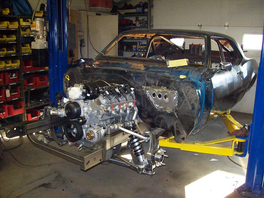

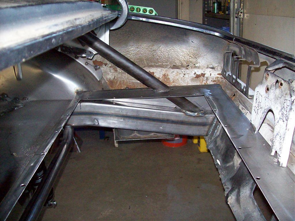

im new to this site and thought i would share my project with you guys. I just started building this in november and all the fab is done now its currently going thrugh the body work.
I found the camaro in north dakota in oct which was 90% rust free except for windshild area. Due to a rough life and a few accidents the quarters, door skins, and 1 fender is being replaced due to heavy filler and poor patch panels. car was complete with orginial 327
things done to date
Art morrison corvette front subframe & tri 4bar rear subframe
9 inch strange alum center 3:90 gears 31 spline axles
strange coil overs
art morison headers and motormounts
DSE mini tubs & firewall panel
15.1 agr power rack
ls3 & t56 built by street rod engines W/24t reluctor cam & head work
willwood pedel assy with 3 masters cyls
fuel safe 22 gal fuel cell
8 point roll cage removeable side & center bars
08 z06 14" front and 13.5" rear brakes
