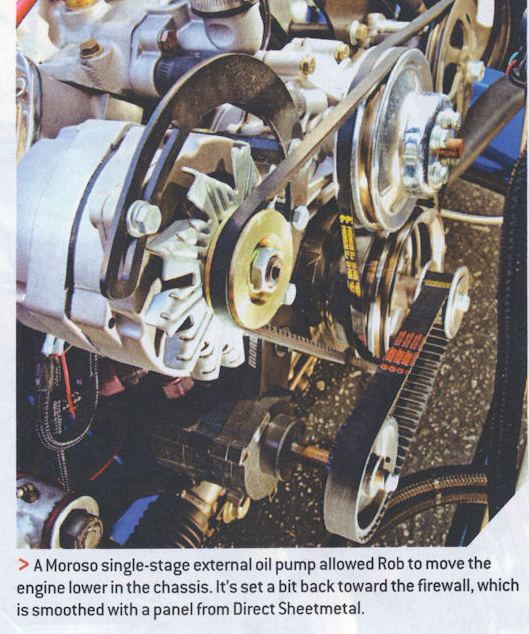

Dry sump?
Thanks Dad!!

Originally Posted by Che70velle View Post
Dry sump?
Maybe not even a true dry sump but just a crank driven oil pump. I think Rob from No Limit did this on his original slant cab F100 pro touring truck so he could lower the engine further.
