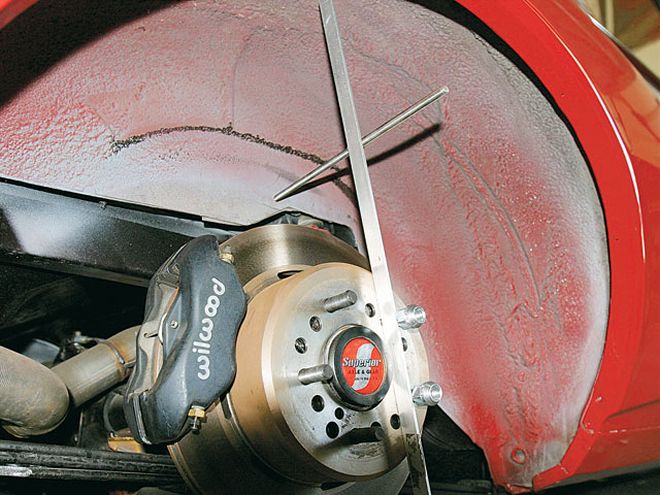

USAZR1 is right..... rent or borrow or purchase (and then sell afterwards) a wheel fitment tool, rims and tires are expensive enough let alone when a oops is made .

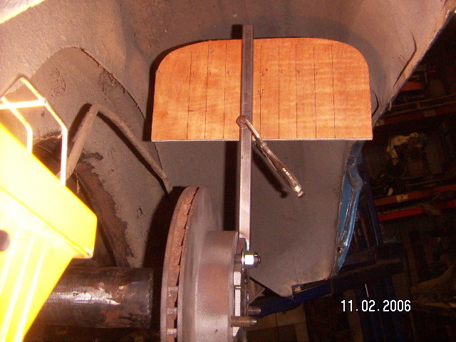

You can make one of these out of angle aluminum and then make a "mock-up" tire out of plywood or hardboard.
Set the offsets on the wood and adjust. The angle bolts to the lug nuts...
As an alternative you can use threaded rod instead of wood.
