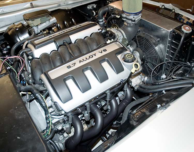

It has taken longer than expected, I have another life too you know like work and such.
Anyway here it is. The engine is in place and ready for start up soon, just finishing the wiring and off we go.
What is left to do here is brackets for the AC-pump, but I will start the engine first to iron out eventual bugs in the installation. There will also be a aluminum pipe for the airfilter. The filter will be behind the left headlight.

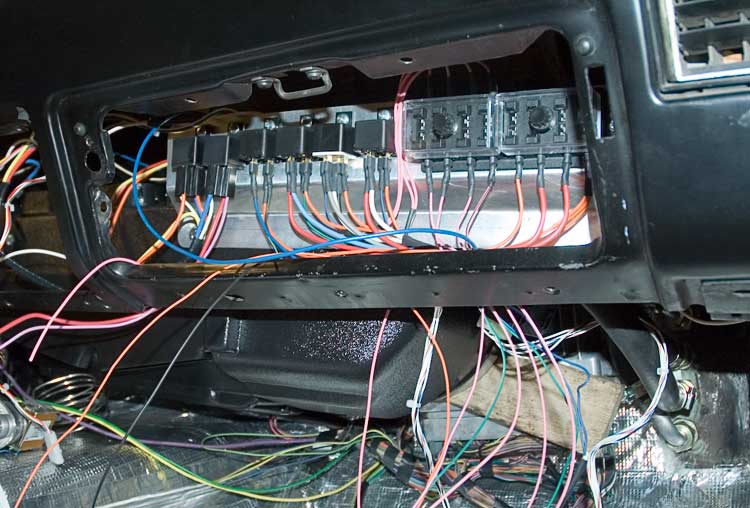

The work on the wiring harness is in full progress, I will have the glovebox full of relays, fuses and cables. What you see on this images has been revised with more relays. In total there will be 9 relays and 12 fuses to service the engine and the AC system.
