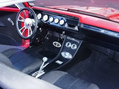

Hey guys.. It feels like it has been forever since i have been able to drive the car.. but its only been alittle over a year. i dont really talk very much on here im on here reading and learning most of the time. this is my first old classic car. i have had all kinds of cars (supercharged vipers, supras, vettes, cobras etc) so here is the info on the car i hope you like.
1965 chevelle 18/20 intro forged wheels
full air ride tech with shockwaves and musclebars and strong arms
speedtech billet aluminum trailing arms
ls2 motor with full a/c 19k miles
speartech harness
built 4l80e 0 miles
new garrett gt40 turbo
new turbonetics 44mm wastegate
good size front mount intercooler behind front grill
new greddy bov
60lb injectors
new a1000 fuel pump
4inch down pipe/exhaust with speartech muffler
new 12 bolt posi rear end with wilwood brakes
clear headlights with hids
led tail lights
im sure im forgetting alot of stuff. im only running 7psi which put me at 500rwhp and 550rwtq. I will have A video soon of it on the dyno. and the blue hoses are no longer they are black. let me know what you think. id love to get some different wheels if anyone has any. 18/19 front and 20x10 rear
HERE IS A BETTER PICTURE OF THE INTERIOR/ THE ONLY DIFFERENCE IS THE CENTER CONSOLE..
