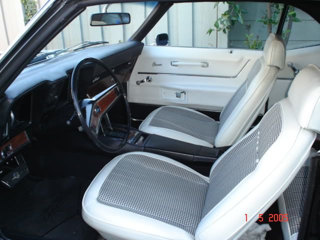

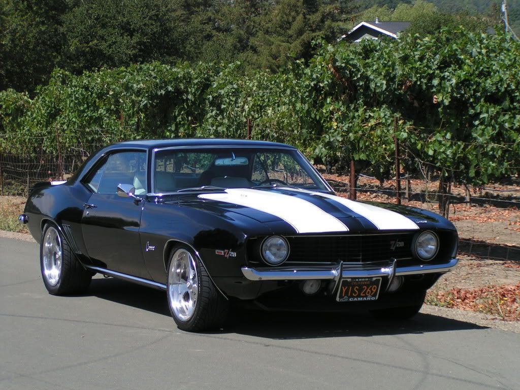

Well about 4 years ago now I was able to pull the trigger and picked up a really nice 69 Camaro badged as a Z/28. She was a beautiful black with white rally’s, had deluxe houndstooth interior with a good start on the suspension including 4 wheel disc brakes and Hotchkis drop spring. The 350 was solid but with the TH350 and a 3.42 12 bolt it was slow out of the hole and around town.

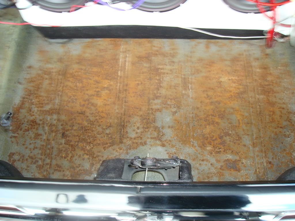

The car came with records and receipts dating back about 15 years so I had an idea of how it got to its current state. The paint was a great 5 footer… had some checking in the lacquer paint and some rust over both rear wheel wells. Soon the itch and inability to leave well enough alone took over and I started checking in to what it would cost to fix the rust and checking.

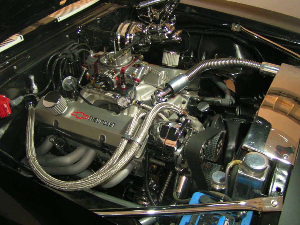

Started with this - love the belt drive BTW

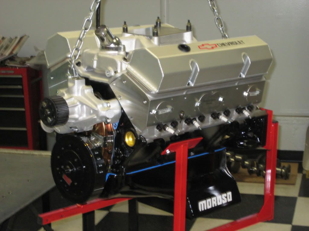

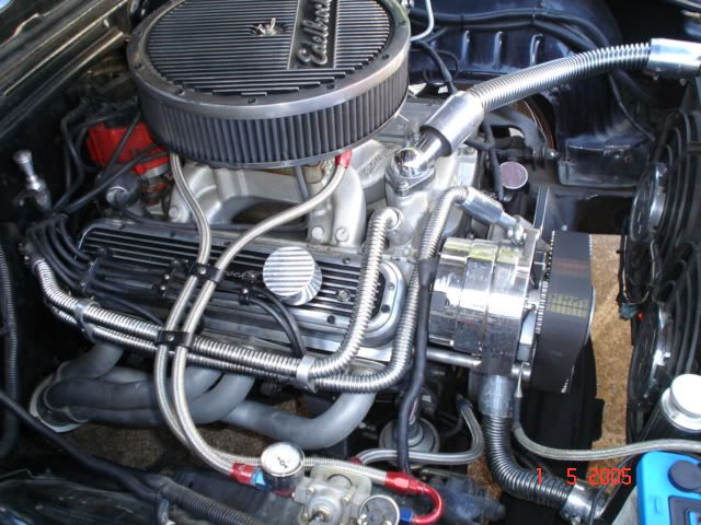

Ended with this - a little 383 stroker

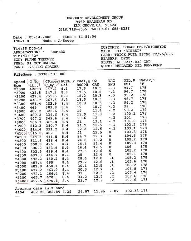

At break in it dynoed 470HP and 515TQ ... a definite improvement

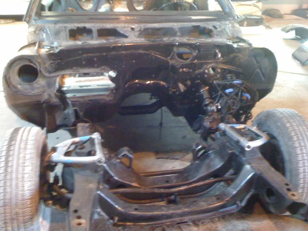

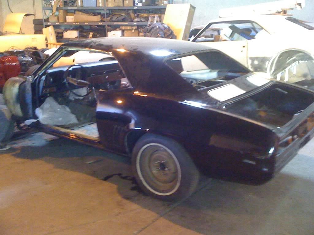

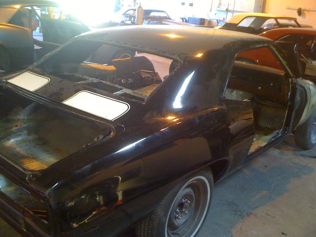

Tare down

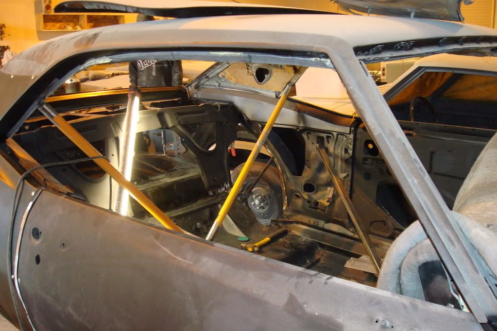

Back from the blaster

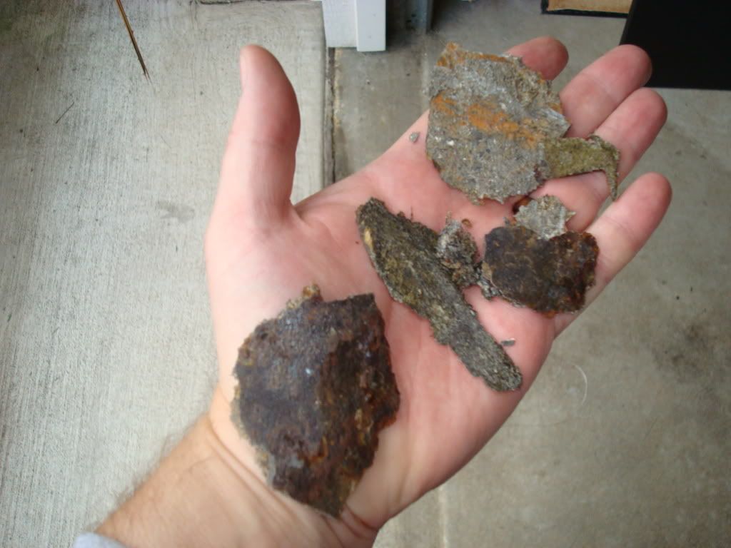

While replacing the tank and leafs I noticed one of the framerails had a lot of undercoating on it. After scrapping it off it was evident that it had been straightened and the damage had been hidden nicely by the undercoating. Bastards! there was even a crack all the way around it that was filled with the undercoating. When I bought the car it wasnt visible as it was right behind the shock and well disguised. This picture shows where she was hit.
With that and the rust over the fender wells it was decided to replace both quaters since the truck was pretty much toast. I knew something was repaired since one quater lip was a 1/4" higher than the other when measuring ground to fender lip. The frame rail and body damage explained it and I'm sure it lead to the trunk not sealing properly causing the rust.

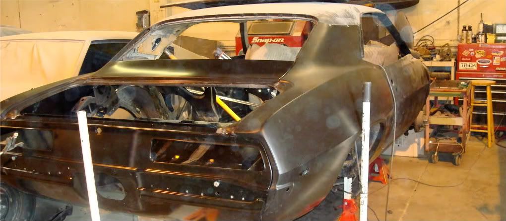

So the start of the "evolving" project... since we were going to basically have the back half of the car off we might as well minitub it right? So new quarters, trunk, valance, tail panel and frame rails went in along with a set of DSE minitubs.
Unfortunetly all of the good pictures of the panel replacements were lost by the builders. (Camera issues) Above you can see the driver side wheel well out and the new quater on the passenger side.
All the new sheet metal back on. It only took about 4 months to get to this point.

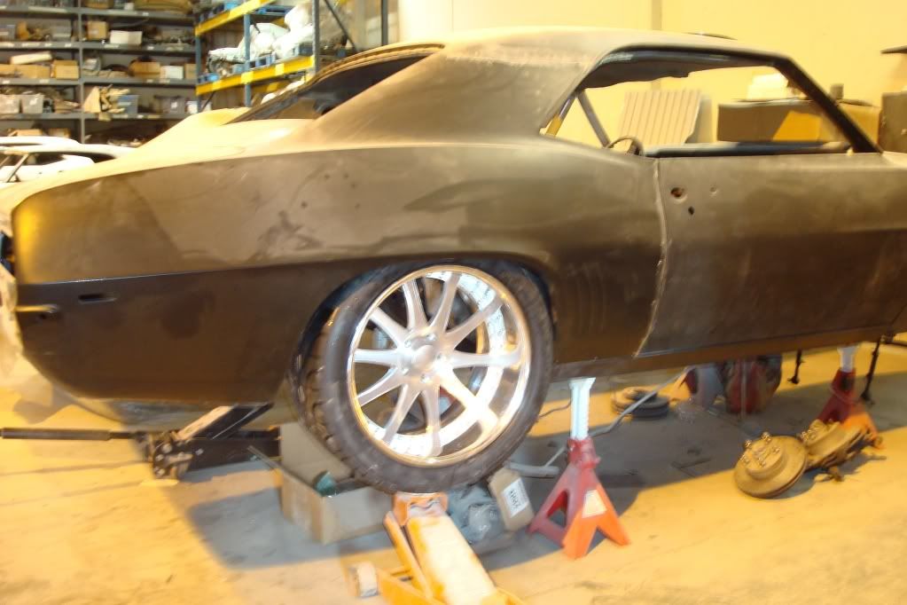

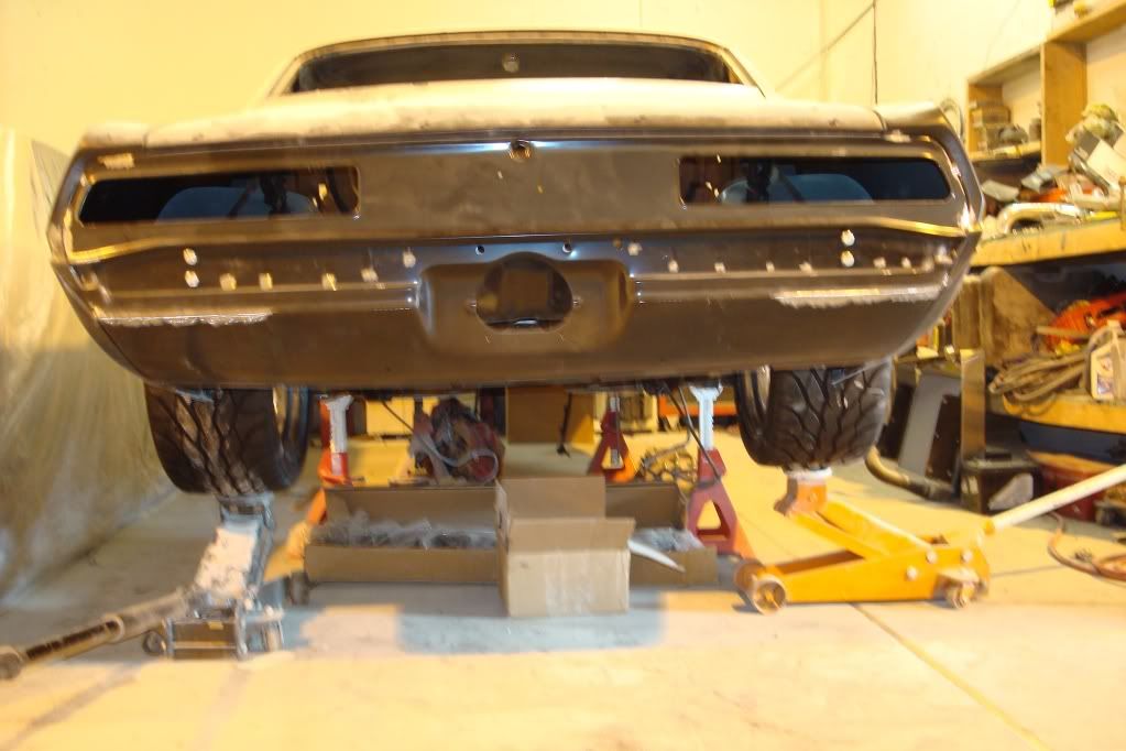

Mock up with the wheels for rear end measurements

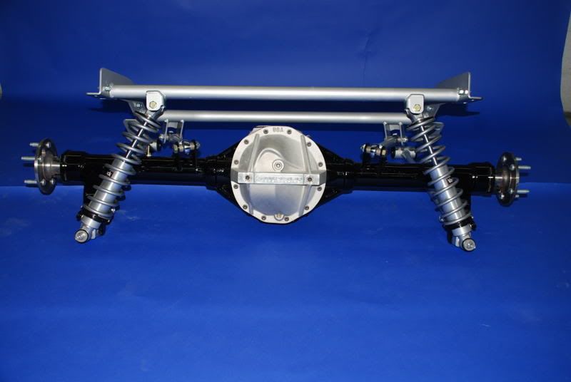

As you can see the Rated X's will fit Nicely. Once we had the rearend out I did some research on the numbers. Come to find out it was out of a Chevelle and the upper control arm brackets had been cut off and ground down. Another nice little surprise. So that led to the next decision... suspension. I have always loved the the look of a slammed 69 so I decided to swap out the suspension and go with AirRide. Since I was going to have to shorten the rearend to accommodate the back space I wanted on the wheels I decided to just get a Moser setup from Frank at Prodigy with all the bracketry already in place.
Nice set up and I found a guy who wanted the date code rearend I had for his Chevelle and was willing to weld on the missing brakets who paid me more than half of what this one cost. (This has been a constant theme through my project. I have been able to sell the parts I am replacing, in most cases, for at least half of what the replacents cost). I ordered the Moser from Frank... having to deal with some of his "delays" that you have likely read about... and finally got it about 6 weeks later.
I got the AirRide setup through Matts Classic Bowties out here in the Bay Area. These guys are awesome!!!!! I know some of you think Frank walks on water and I know he has helped a lot of you out, shoot he's helped me with advice too which I appreciate... but the "shipping issues" where too concerning for me being 3000 miles away. So, for us left coasters, I've found the team at Matt's is just as resourceful, competitively priced and they stock most of the parts they sell which is way more convenient.
