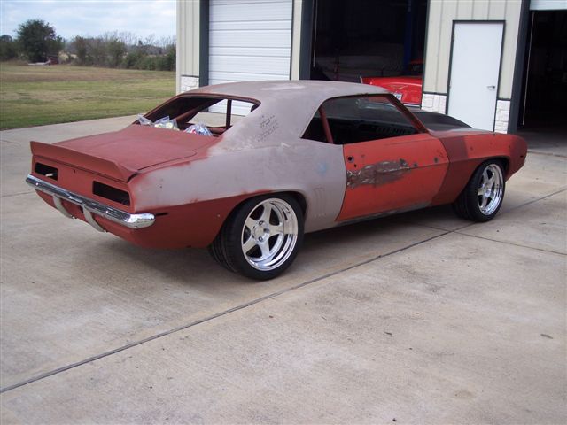

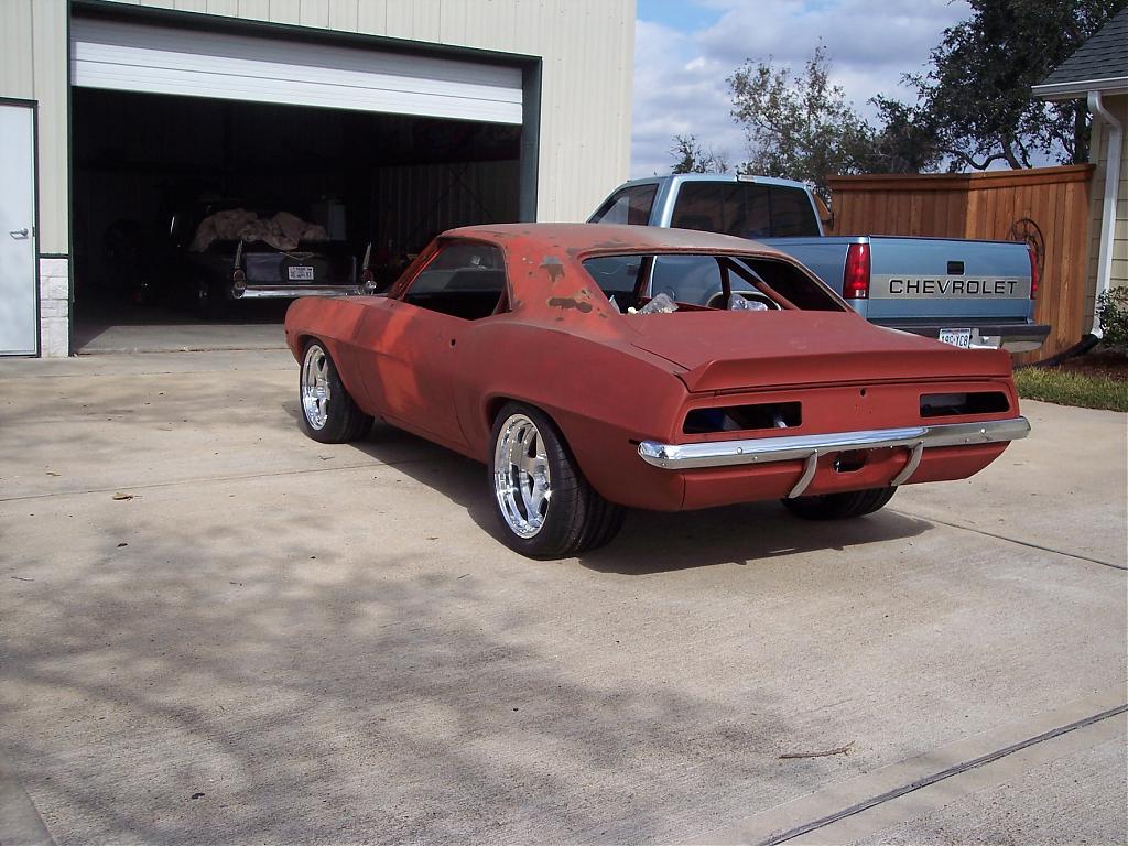

I have been on this site for a couple of years now talking and learning from many of you. This site has defiantly helped it's vendors as I have dealt with many from this site. (with great results) The car I have been building is a 69 Camaro with a ProCharged intercooled LS 418 should put between 650 to 700 to the rear. The tranny is a new Rockland T56 6 speed, the rear is a Moser 12 bolt with a G bar suspension, front is a AME subframe and the brakes are 14" Wilwoods. Colors will be black with white Yenko stripes with all of the emblems and the wheels are Fiskes just like on the Mule.

Oh Yeah, that's not the hood that is going on the car.

Nice build, post some bigger pics if you can. Glad you are not using the large cowl hood.

If you can post larger pics, if possible, that would be cool.

Bigger pictures

Couple of questions for you:
Did you need to modify anything on the ame frame or move the radiator to use the pro-charger?
Are you using the stock pro-charger bracket?
Where did you get the air inlet that is on the pro-charger?
How much clearance do you have to the pro-charger to the radiator?
Is that a d1 or f1?
