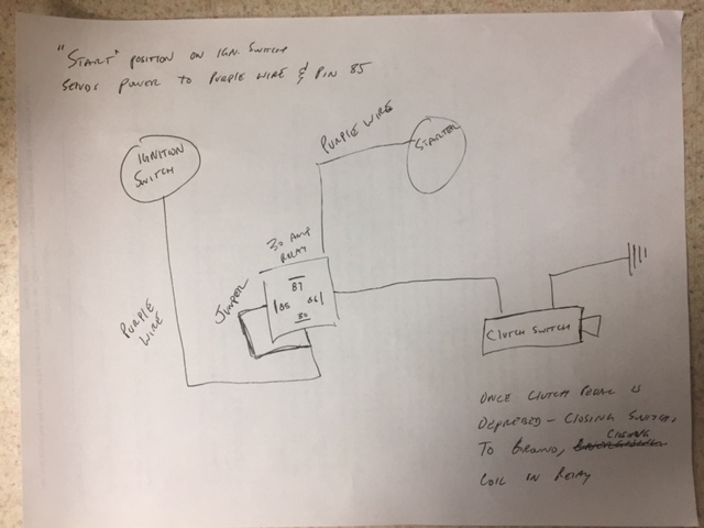

trying to figure out the wiring for a neutral safety switch on the clutch pedal.
i think this is the correct way to wire it.
-"start" position on ignition switch sends power to purple starter wire and pin 85
-once clutch pedal is depressed, closing switch to ground. energizing coil in relay
YES.....assuming the "clutch switch" closes the circuit when the pedal is on the floor.....

Got the battery hooked up and function tested my wiring. All seems good so far. Fluids and gas this weekend/week for the first fire up
Clutch pedal neutral safety switch worked perfectly
