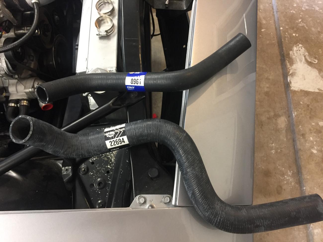

Looking for help on the radiator hoses
griffin rad with in and out on same side
corvette ls2 motor
any suggestions is appreciated
corvette ls2 motor
Lower hose ACDelco 24403L trim to fit.
Upper hose pretty sure a section of this will work. Gates 22358
Don
The Following User Says Thank You to dhutton For This Useful Post:
Brianstanford (10-22-2018)
corvette ls2 motor
I went with a couple from NAPA. Looks like your radiator layout is really similar to mine. I've got part numbers and pics posted on page 11 of my build thread if it helps...Nice project, btw, been following along!

Upper and lower radiator hoses. Both had to be cut a little to fit
