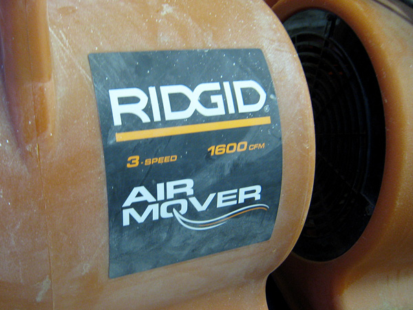

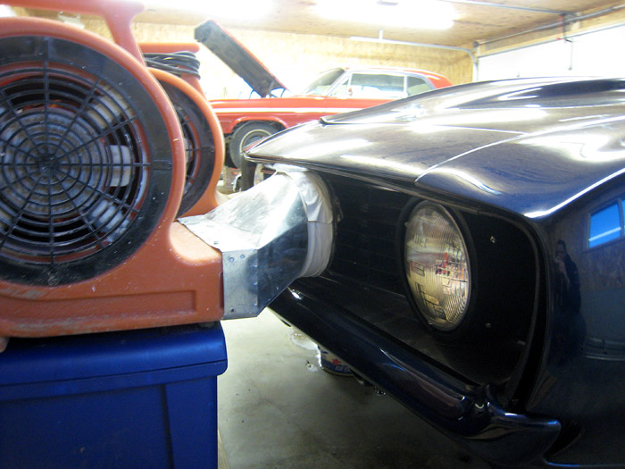

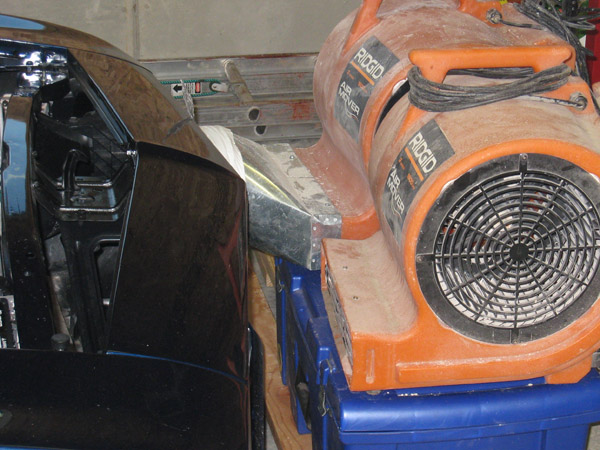

Played around with some 1600cfm blower fans. I turned them on after the gauge passed 210. The extra air movement dropped it back a little below 210. I let it idle for 15 minutes and it stayed consistant. The coolant is full and I believe I have the air out of the system. Does it sound like a couple decent puler fans and a shroud will do the trick? Should I be shooting for a lower temp? Are there more things I should be checking?
Thanks
