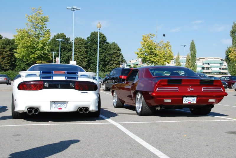

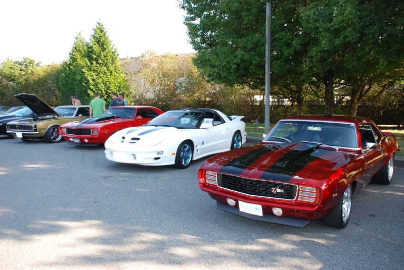

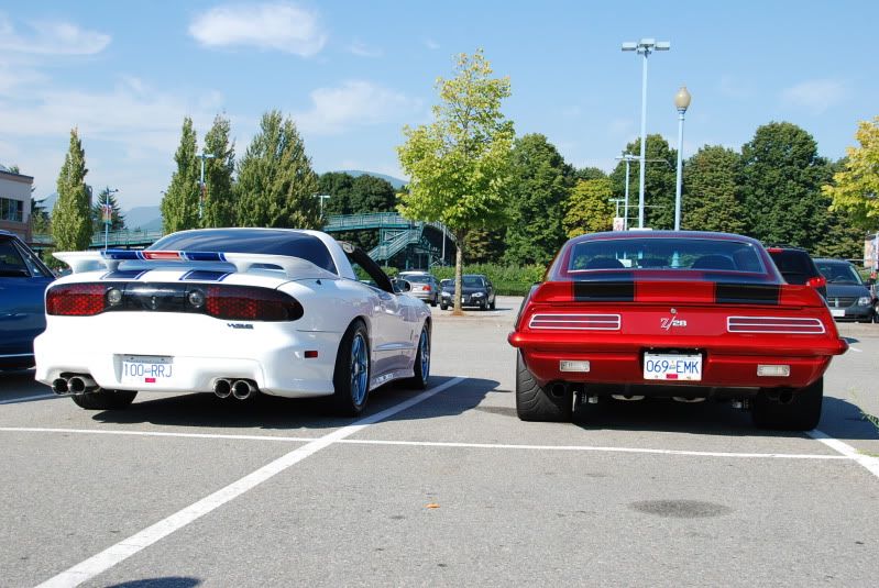

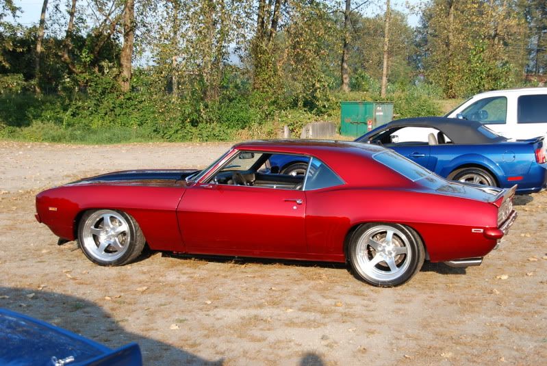

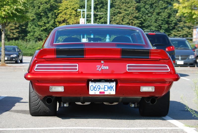

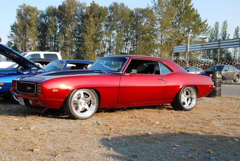

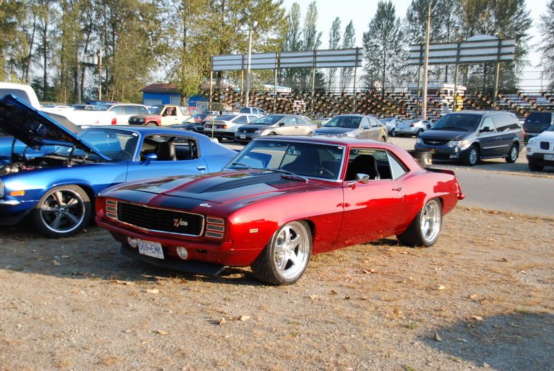

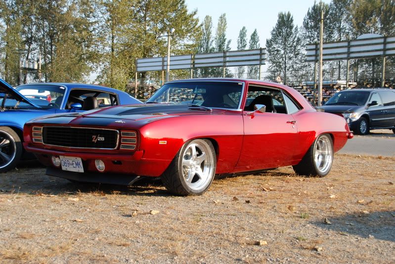

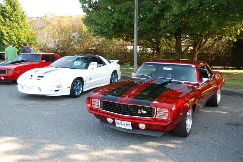

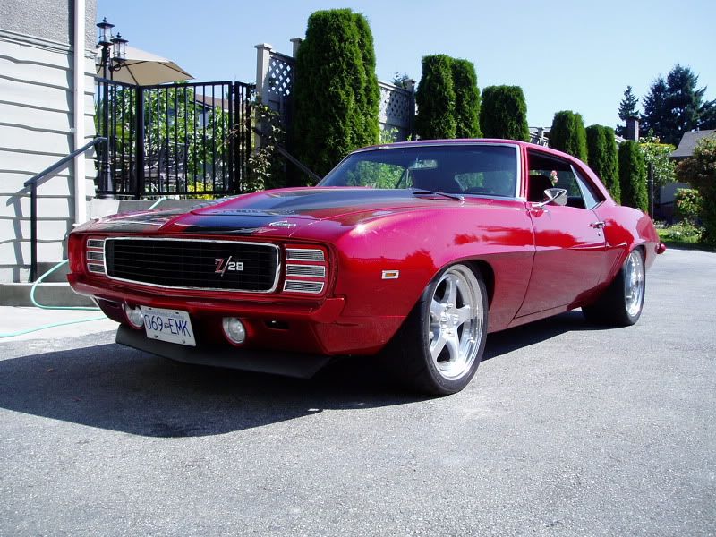

These are pics of the wheels when I first got them. I originally ordered 6.375" BS on the rears. And when I got them I just wasn't happy, I wanted a deeper lip. So I contacted the Rep Danny Gol and we made a deal to re-hoop the rears to 5.375" BS. This took a few months as well. Fikse is a little slow, but they were very good to deal with and they are local to me now under new ownership.
Anyways, onto some pics.
18 x 12 6.375" BS
18 x 8.5's
With Toyo R888 Rubber.
245-40-18 fronts
335-30-18 Rears

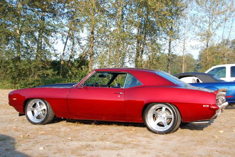

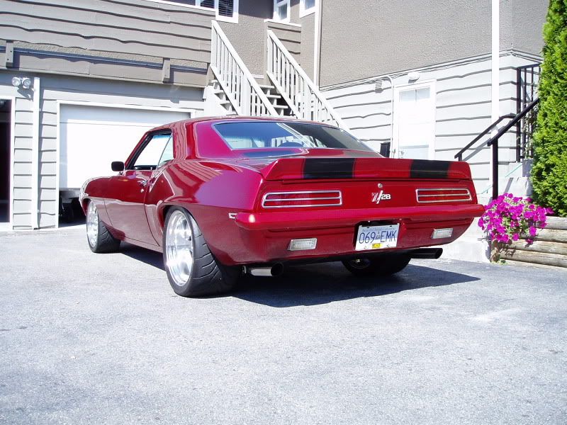

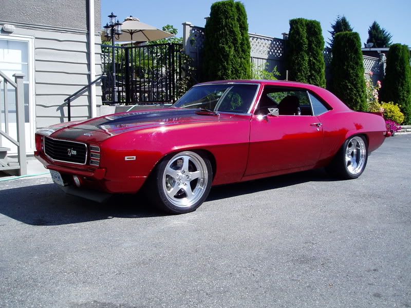

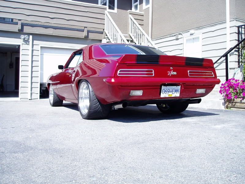

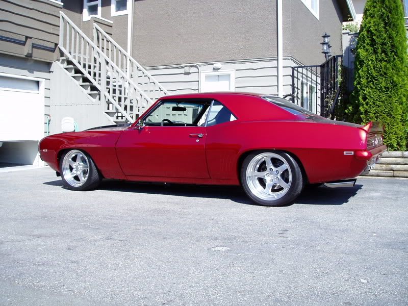

So after I had the wheels Re-hooped to 5.375" BS they now look like this:
