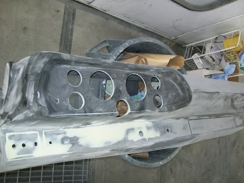

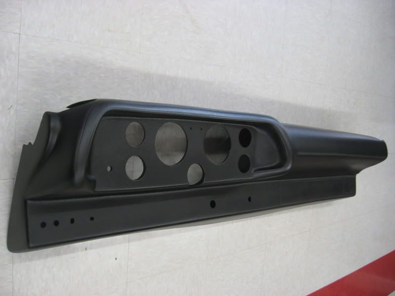

Originally Posted by DJW32 View Post
The interior is looking good.
What textured product did you use on the floor, trans tunnel, and trunk?
On the dash, I used a 3M light gravel guard and sanded it down. After that, SEM trim black. The trunk floor and interior floor has bed liner. I wanted a durable floor that cleans easily. I don't have cup holders, so I may spill.
The gauges are Speed Hut.
The dash looks nice. What product was it painted or dyed with?
You do realize this is a fiberglass replica, not an OEM dash and pad...?
How is the gravel guard applied? Is it an aerosol?
I can't seem to find it.
http://www.shop3m.com/3m-undercoatin...m3xv860k8.html
Here is the product I used. Sorry for not giving the proper name earlier.
http://www.shop3m.com/60980009868.html
I applied about 3 - 4 coats and then primed and lightly sanded the high spots down. Trim black to finish it off.
