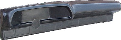

1) About the dash... in an earlier post you mentioned its a VFN dash. I looked on their site and the picture they have posted looks different than your dash (the gauge area is more recessed). Did you modify that section of the dash, or is the picture on the VFN site just not accurate? I like the layout you have better. Here's the picture from their site (http://vfnfiberglass.com/site.htm):

It is a VFN dash that Maier Racing customized for me. The instrument cluster was moved back to clear the roll cage. Maier Racing does a lot of custom fiberglass work, so it was easy for them.
