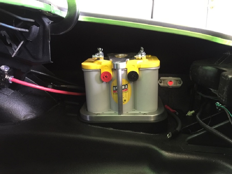

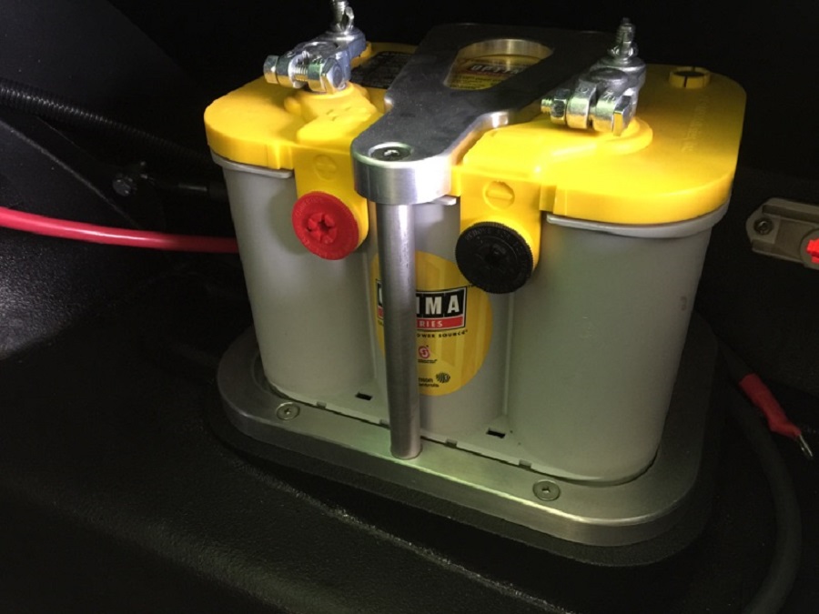

A few more update pics..... I relocated the battery to the trunk and built a platform for the battery mount. I know these batteries can be mounted on an angle, but thought this looked a little more "finished" to have the battery sit level. I ran the positive battery cable all the way to the front of the car, but ran the negative cable to the body and to the frame at the rear of the car. Of course the motor will be grounded to the frame and body as well.
I know there has been some debate on the best way to do this...... Any thoughts on NOT running a Negative cable all the way to the engine????

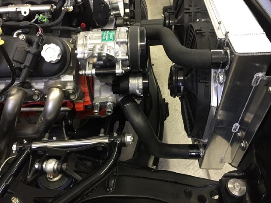

A few pics of the throttle cable bracket I fabbed up for the drive by cable FAST throttle body. I was leaning towards buying the billet version, but making parts is half the fun (cheaper)..... Also put in my radiator hoses with the heat shrink clamps. These look real clean when installed.

I'll be anxious to see what you come up with for the shifter as I am in a similar situation. Also very interested in learning more about those Tiburon seats, are they power and or heated? I don't know if I missed it but whose radiator is that? The hoses look great with the heat shrink. What hoses did you use? The pics are great, really like the battery support. Thanks

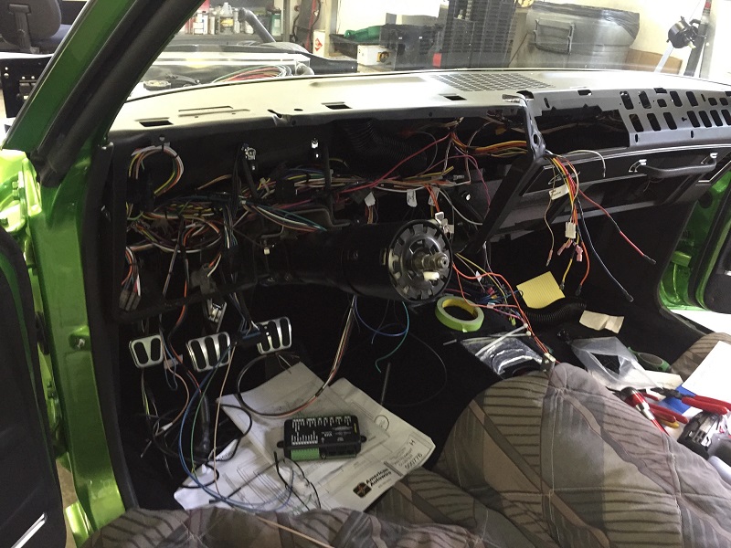

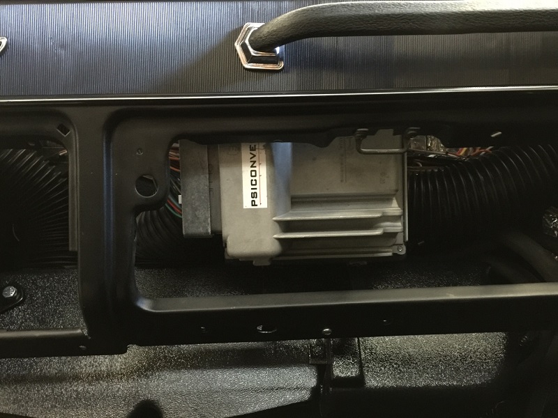

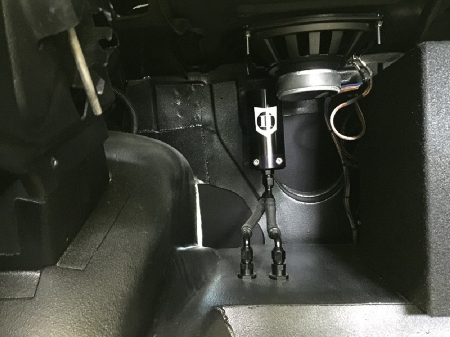

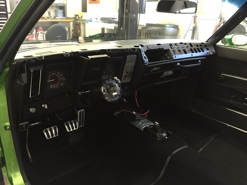

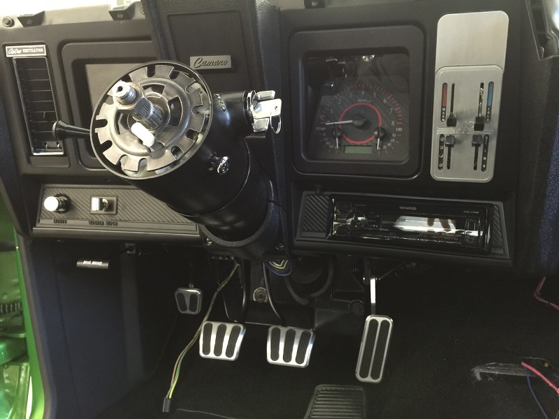

A few pics of the interior.... finally feel like I'm turning the corner. Let's hope all that wiring was done correctly!

Car is looking good, any chance you can let me know what part number that lower rad hose is?

The lower hose is a Gates 20450 and the upper is a Gates 22358 "cut to fit". These worked out great.... it was like they were made for the car!
