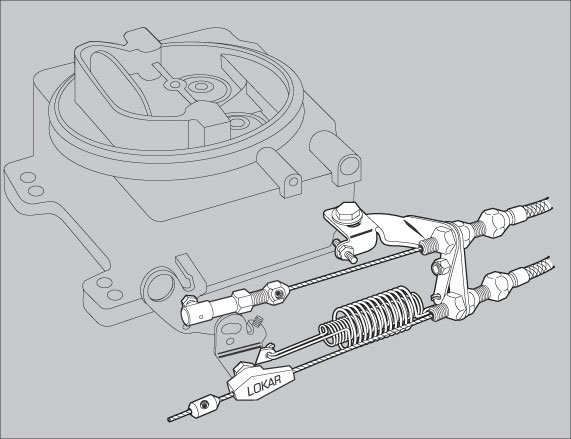

Originally Posted by 68protouring454
did the srk 4000 come with the springs, and will it mount the throttle cable at the carb? thanks guys
Yes, to both questions. It came with the springs and it bolts to the back left carb mount stud. The pic attached shows the diagram. I'm running a 5 speed so I did not have to run the kick-down cable shown in the diagram.
Kevin
