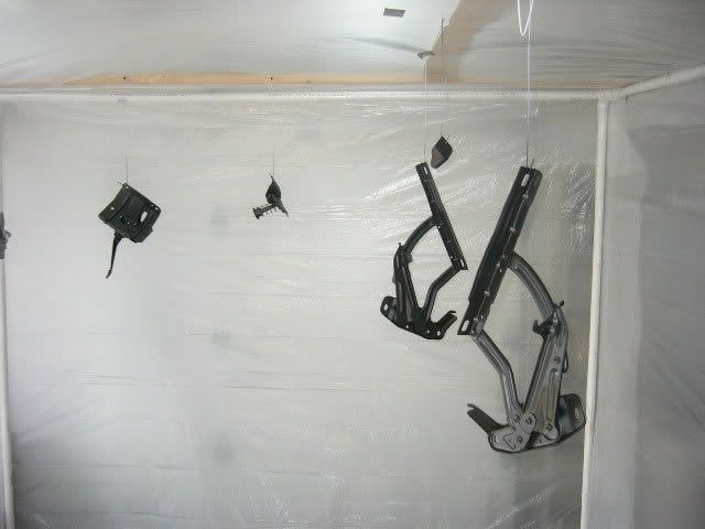

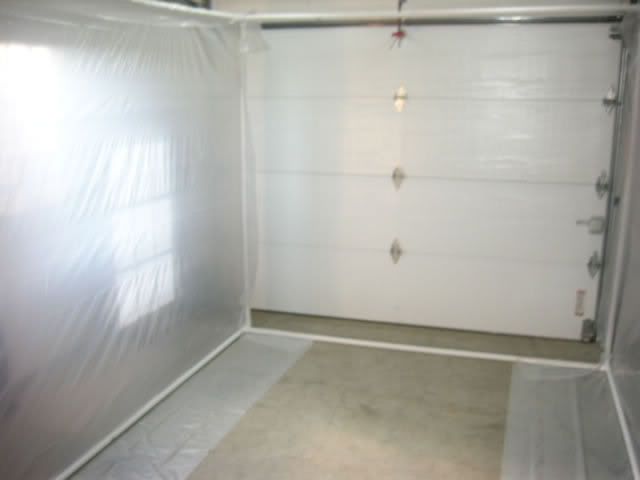

Well, I lied about pissing off your wife. My wife is still upset that she “did not get her garage back” when I sent my car to a local body shop. Now, when she complains about me spending time in the garage, I remind her that the sooner I get done the sooner she can get the garage back!
I spent about $75 dollars in materials and it took about 4 hours to build. I am sandblasting and painting all the small parts instead of paying someone else to do it.
I have used the paint booth several times over the past two months and it works great! It keeps the fumes from getting into the house and I don’t have to worry about dust, bugs, dirt getting and the kids touching the wet paint.

Below are some pictures:

What's the aerosol adhesive for? I'm assuming that you used it to hold the pvc and platic wrap together. What mil plastic did you use?
Yeah, your right…I used the aerosol adhesive to glue the plastic to the PVC pipe. My original plan was to use a bunch of tape, but my father suggested that I use the spray adhesive. It worked well and sealed everything tight.
I believe I used 6 mil plastic. Its pretty thin, but effective. I would probably use something thicker if it was going to be outside
Good luck!
