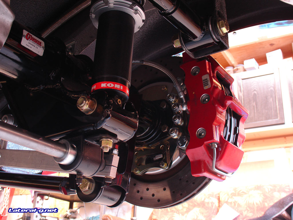

Installed the parking brake assembly this weekend. What a great kit.
Parking brake cables will be here this week and that job will be done.

Originally Posted by XcYZ View Post
Yep, I'm running the new big style/Torino bearings, but this kit is available in 3 different 9" housing end bolt patterns.
About $700, depending on options. I ordered a several brake lines from Tobin as well.
Im going to put a 9 inch in my Camaro and yesterday was given a complete set of C6 calipers . What 9 inch housing should I look for ,is one better than the other???
  #20
Old 03-26-2008, 06:55 AM
XcYZ's Avatar
XcYZ XcYZ is offline
Join Date: Jun 2004
Posts: 8,998
I have the Torino style big bearing housing ends and that's what I'd recommend. Its 2.5" housing face to axle flange gives enough room for the DIH parking brake.
Here's what Tobin at KORE told me about his brackets and Ford housings:
As far as applications go, the kit is only compatible with the Big-Bearing Torino style housing and soon to be the Small-Bearing housing as well. The old style Big-Bearing housing with 1/2" T-bolts will probably not happen due to the very short brake offset dimension of 2.36"...it's causing interference issues between components that we may not be able to get around without excessive tweaking.
