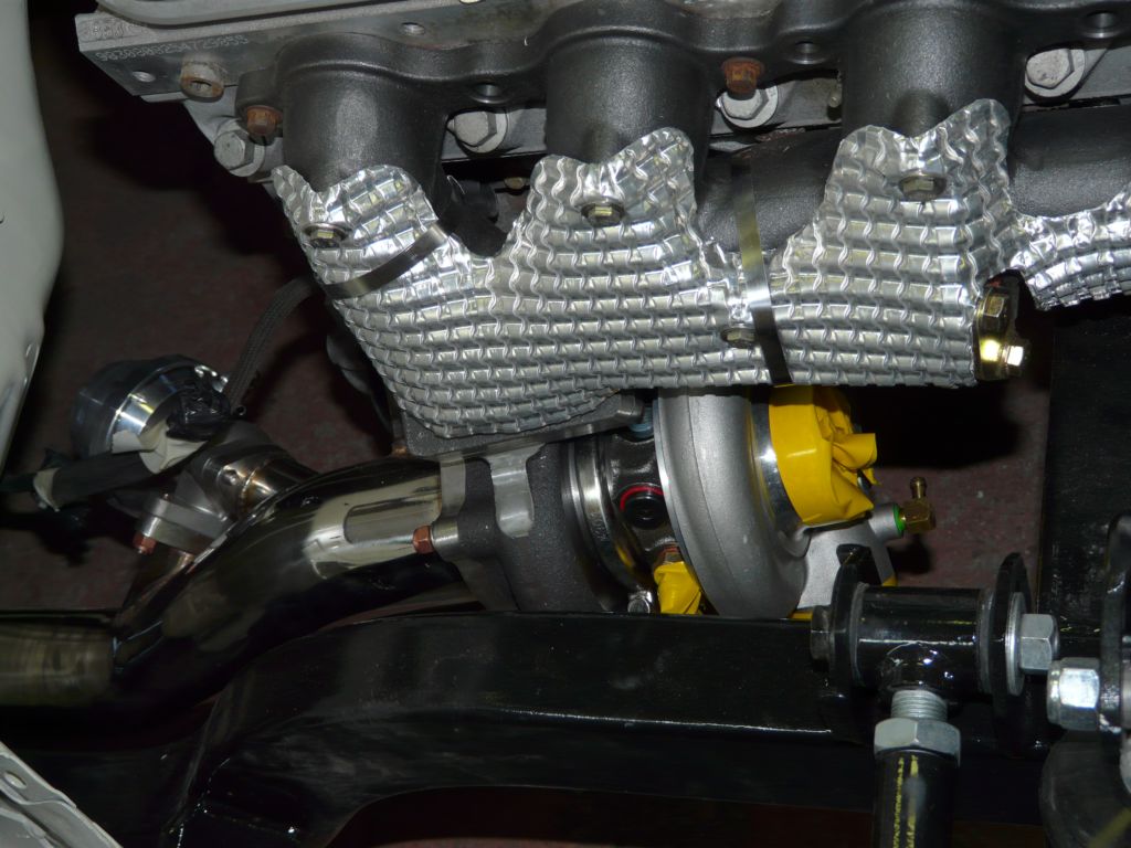

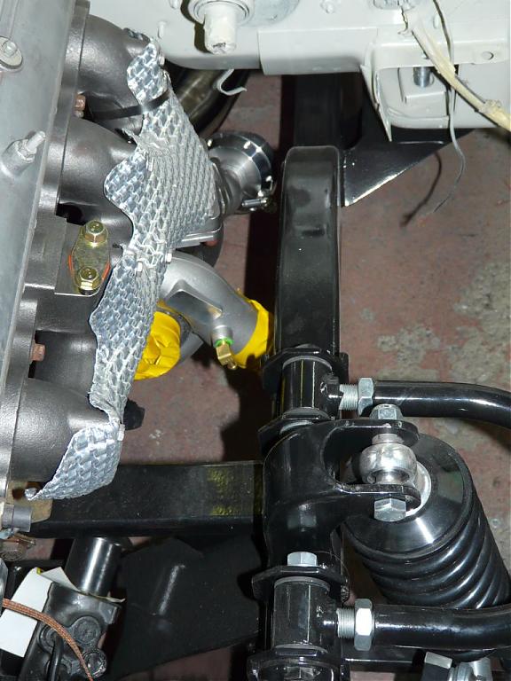

Test fitted the turbo kit today for clearence
