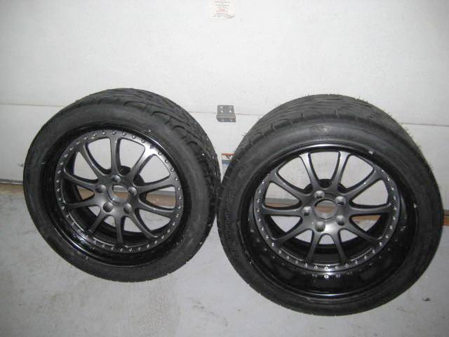

Wheels showed up earlier this week, just had the tires mounted (splined black mcgard lugnuts are here as well)

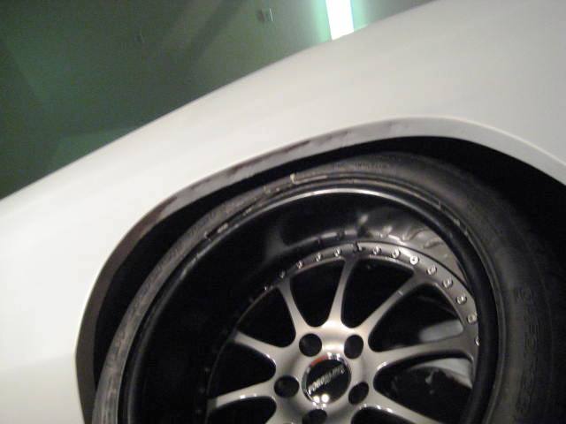

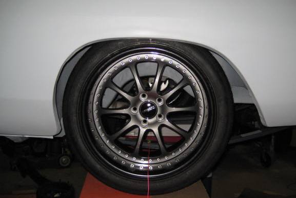

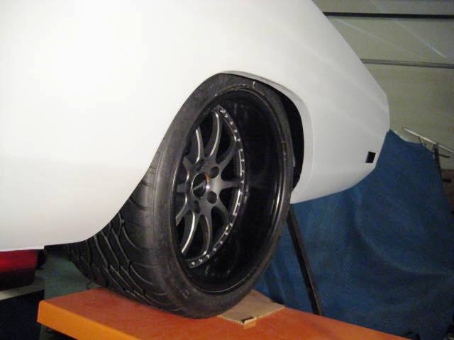

I'm in the process of mocking up to determine rear end width and not terribly happy with the clearances - mods are required.
Take a look and let me know what you think - especially concerning the fender to tire clearance. With these pics, I have 1" clearance to the fender lip, and the lip is 1" wide. I think I need to trim 1/2" off the lip and roll it up a tad - then push the tires out another 1/2-3/4".
Btw, tires are mocked with a ride height of 5" ground clearance...
Opinions?

WOW! Are those automotive jewelry or what? There is no better quality wheel then Forgeline! Pretty damn light aren't they! Your going to love cleaning a wheel with the inner powder coated to. This often hard to clean area is a real bitch to clean on NON coated inners. For you, windex and a paper towel!
If I remember right (we just did one of these car), you can trim that lip about a 1/2" and gain some clearance without removing the lip or rolling the lip. I don't think there is any reason to trim more then a half inch though as the outer wheel house is the next interference after trimming that edge.
I love the tire to panel profile, long as it does not rub. Just so long as we don't get that "sucked in" Pro Street look!
Square them up and get me a measurement and we will get your Moser ordered.
And again, WOW!
