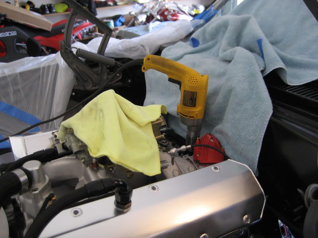

I added fuel tonight to prime the fuel system and check for leaks. I had 4 leaks. Two at the carb bowls and the fitting on both sides of the pump. I used a pipe dope and the fuel ate right through it. Lucky me!! I had to disasemble all the fittings with the dope and replace it with tape. It's all fixed now but what a mother ######. The carb leaks were caused by a frankly crappy design. They used two gaskets with my high dollar fuel rail. I used the gaskets and tape and it's not leaking anytime soon.
