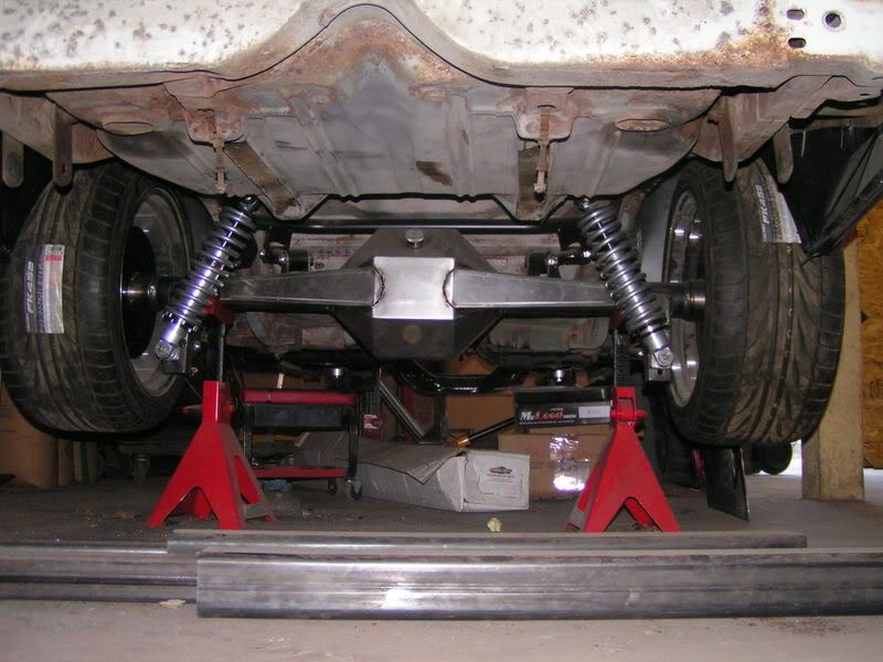

Originally Posted by Every Detail View Post
can i use coilovers with the air bar?and does anyone have any links to these web sites so I can check these other kits out.
Here's the airbar with coilovers. Give Frank at www.gpsuperstore.com a call, he'll set you up.
Mike
Pro Touring 68 Acadian(Nova)
Speedtech subframe with high clearance control arms
Prodigy Bar rear suspension
Ridetech single adjustable coilovers
Wilwood 12.2" brakes
New Gen Splitters
LS3 and TKO600
Link to my build: https://lateral-g.net/forums/showthread.php4?t=14349
