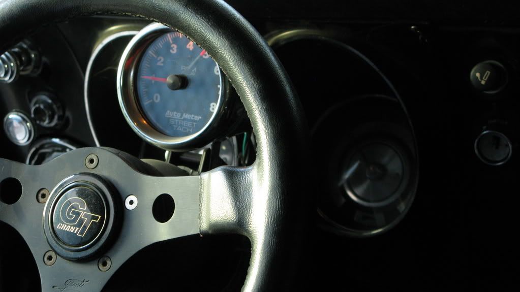

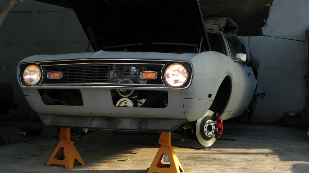

I also took some glamour shots (I got the headlights working!)

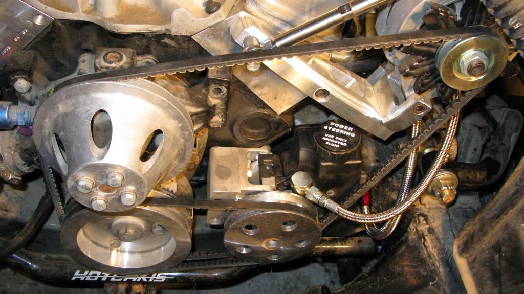

I took Mr. Pozzi's advice and am now running a second dedicated belt to the power steering pump. Here it 's during my mockup:

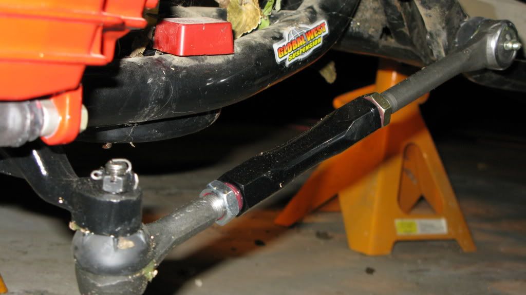

I ordered Detroit Speed's steering linkage overhaul kit, which includes all of the components you need from the pitman arm to the outer tie rods (except the center link). The tie rod adjuster arms are pretty slick looking and solidly made:
I encountered two problems. Firstly, the #6 header pipe is touching the rubber boot of the idler arm. Untreated, it will probably melt, so I am going to wrap the tube with some header wrap to keep the heat transfer minimal. I will continue to monitor it, as body flex or engine torquing could do some damage. The second problem is that with the steering stop knobs on the Global West arms, I am only getting 1.5 turns lock to lock! I know the Lee box's 12.7:1 ratio is quick, but looking at the angle of the spindles at lock, I'm thinking I will need more. Can someone tell me if it is ok to simply grind down the knobs a bit?

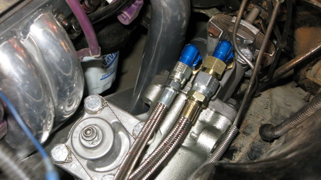

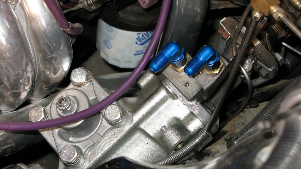

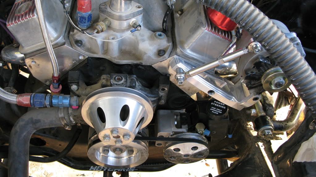

The stainless braided hoses that I got from Unisteer are quality pieces, but I wouldn't have minded if they were made 2 inches longer. The hi pressure line is a -6 female on both sides, which was JUST long enough to be able to route cleanly to the banjo fitting on the pump. The return line though, I had to pull unacceptably tight to reach the reservoir. My solution? Earl's 921106 ($14 each?!?!) 90deg elbow fittings.
And here are the hoses attached. Note that the return line is actually a -8 end, and Unisteer includes the -8 to -6 adapter:
It's amazing what a bit of braided line and some nice fittings can do to muscle-up an engine room

Here's a (dust ridden) picture of my accessory drive system. Thanks again to Mr. Pozzi for "steering" me to run a dedicated belt to my pump.

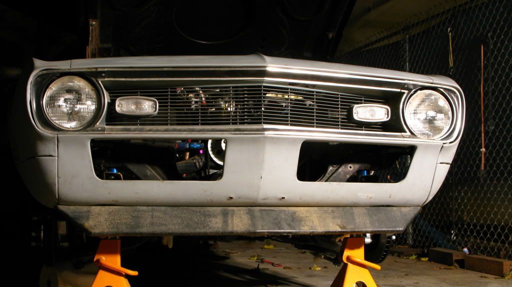

Night shot I took for fun:
