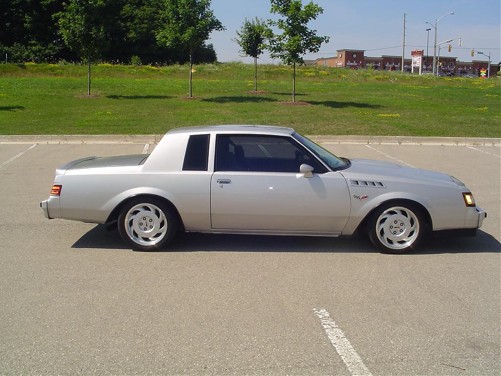

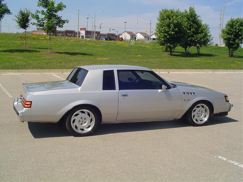

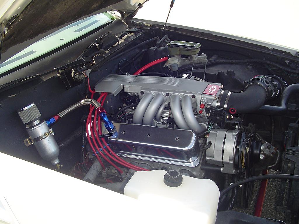

Here are a few new pictures. I finally made a pass down the 1320. I was hoping get a 13 second timeslip, and maybe break a
100MPH in the quarter. My worn out 20 year old L98 is warmed up with just a 95 LT1 roller cam and some 1.6 LT4 roller rockers.
The TPI unit and ECM are from a 87 305 trans am. I did pop in some 27lb Grand National injectors (stock 19lb prom!)
With 3.42 gears and a T5 trans I pulled a not so hot 2.07 60ft but still crossed the strip in 13.72 seconds at 104.7 MPH!!
I couldnt belive the MPH!!! Im very pleased with the car and I know it will go faster with some tuning and better driving.
