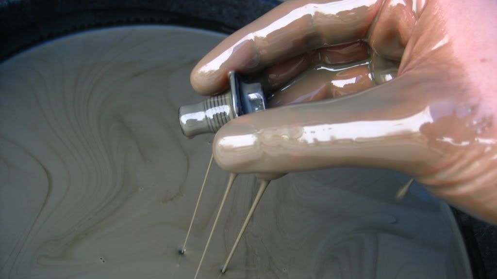

So it sounded like I was running on 7 cylinders. Thats because one of the spark plugs was submerged in antifreeze. And actually, I took my passenger header off and and 2 ounces of fluid dripped from the pipe. As this is my second try with mating the heads to the deck, I'm pretty sure the 40-year-old deck is bad.
Meet my latest batch of oil that I found the day after Christmas:
In my own sick, twisted way though, I was happy...an excuse to rip out the engine, rebuild it, and go with a solid roller cam and a bunch more compression. Besides, I have a 5 speed on my shelf!

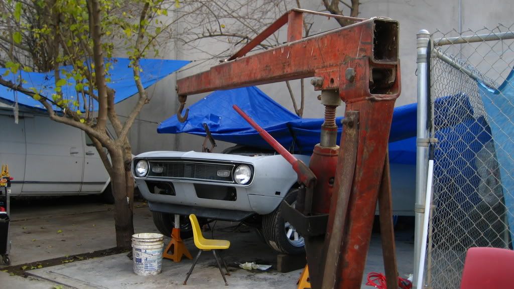

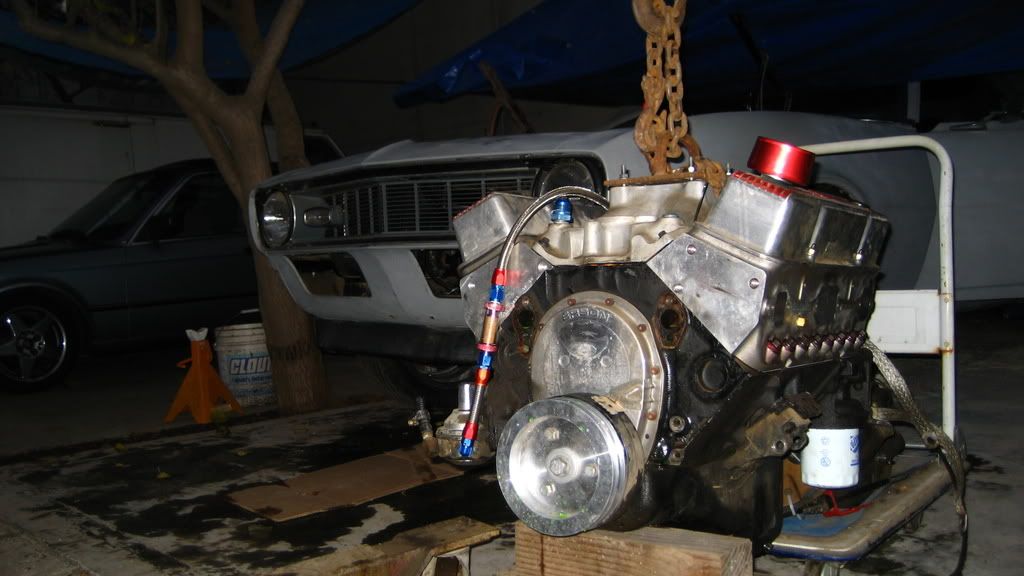

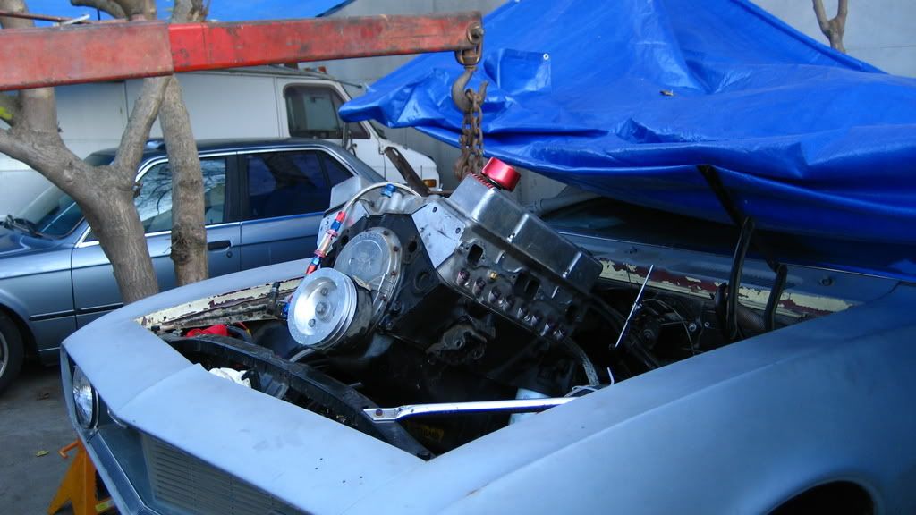

So today, I got my grandpa's "cherry picker" and went to town on pulling the 327/TH350.
The hard part is getting everything ready for the pull, it took 1/2 the day...yanking the engine only took 20 mins.
So, here they sit, torn apart on such short notice. But drastic times call for drastic measures:
